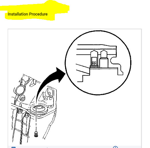

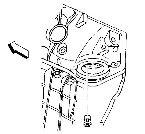

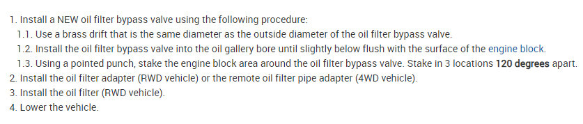

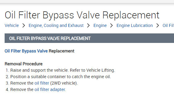

It sounds like the oil filter bypass valve has failed. The valve is located where the oil filter is attached.
If you look below, I attached the directions for replacing the valve. I'm not sure how easy it will be to get one, but they should still be available since the engine is still produced.
Take a look and let me know your thoughts.
