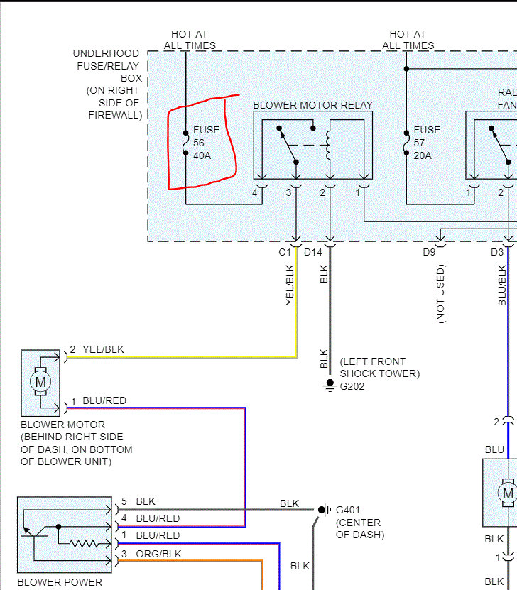

I was using my A/C earlier that day worked fine. Then the same day nothing. I checked the connectors all good. Replaced the resistor nothing. Fuses and relay's seem to be fine.. I have already replaced blower motor and fan 2 years ago.

I attached two pics below. Please confirm that the fuse in pic 1 is good. In addition to checking the fuse, make sure there is power both in and out of it. Here is a link you may find helpful:
As far as checking the relay, that needs done as well. Here is a link that explains how it's done.

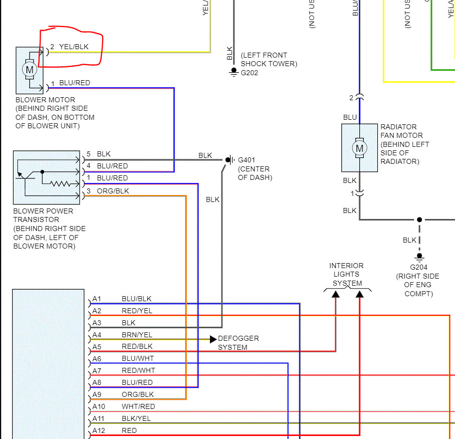

If the fuse and relay check good, I need you to check for 12v / power at the blower motor. (see pic 2) There is a yellow wire with a black tracer that should have power. The power goes to the motor and then a ground path is provided by the control unit in the vehicle.
Check these things and let us know what you find.
