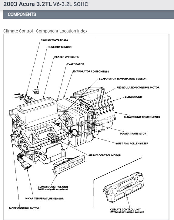

The blower fan can be inoperative due to a bad relay, wiring, or a faulty motor.

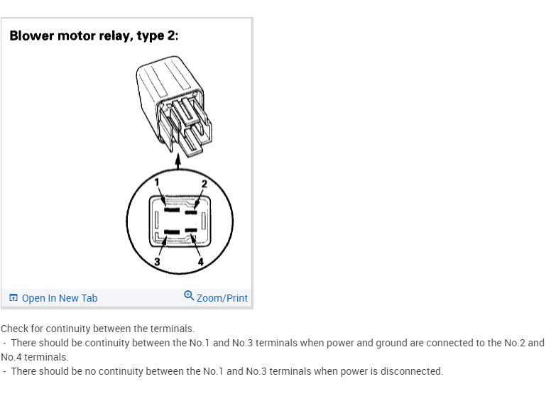

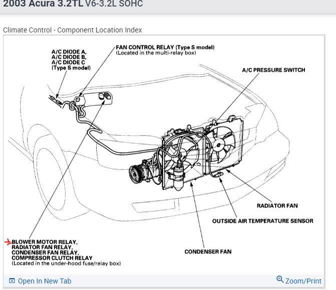

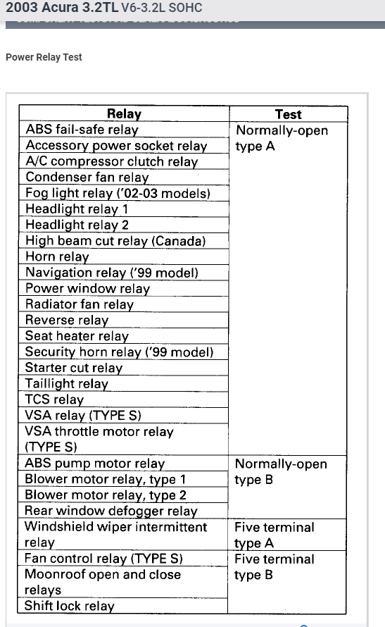

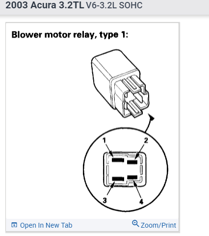

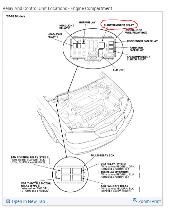

First check the relay, it is located in the under-hood fuse box (see diagrams below).
Check for any corrosion or burnt pin(s).

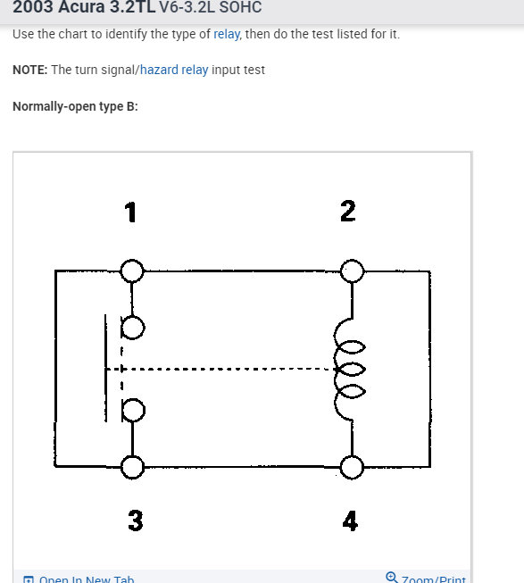

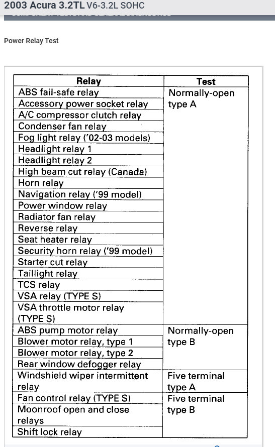

This relay can also be tested.
Here is a helpful guide:

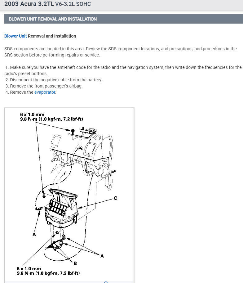

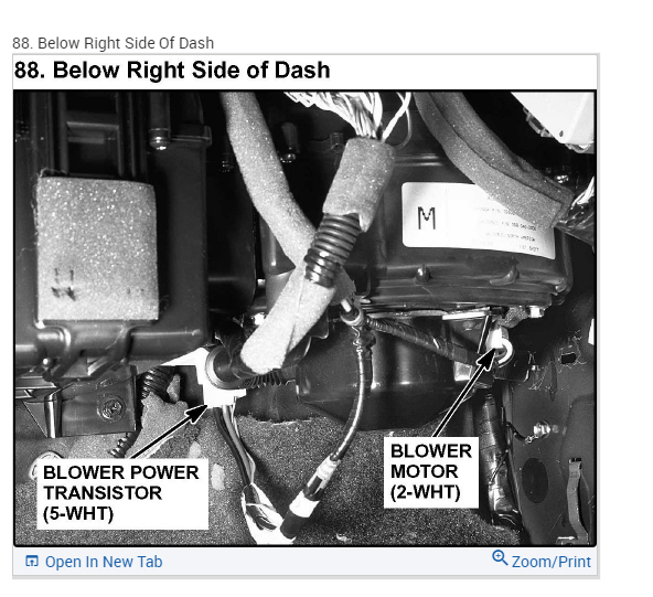

If the relay is good, check to see if there is power to the blower motor harness. If there is power at the harness, then the motor is likely bad. Be sure to check for any melted connectors at the blower motor.
The blower motor is located under the passenger side dash.
