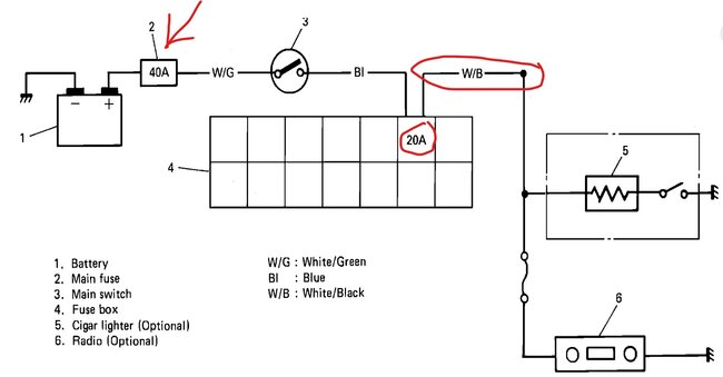

Hello, so while driving my vehicle listed above just quit running after inspecting, I found a fuse was blown and it was the cig radio fuse I replaced the fuse and about two blocks later it died again and now won't start or even turn on without blowing that fuse again?

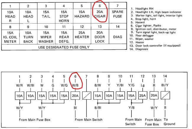

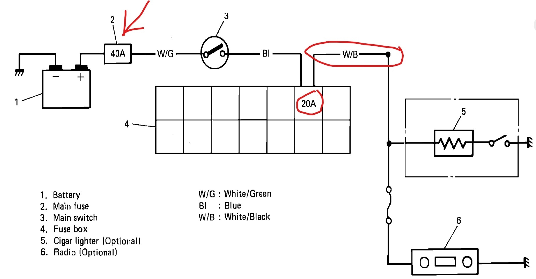

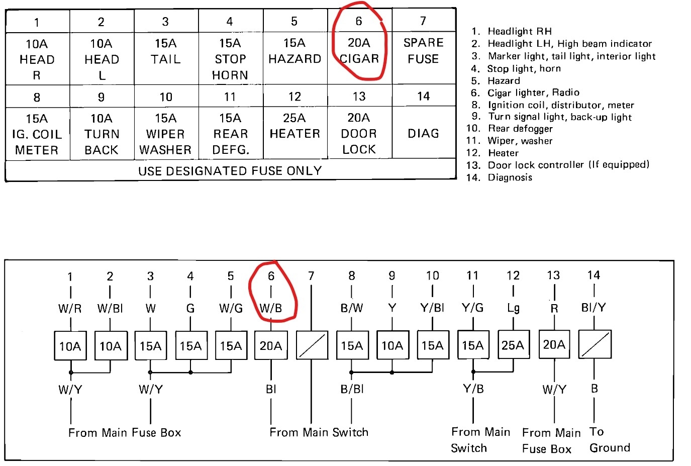

Is it the 40 amp fuse link or the 20 amp in the fuse box for the cigar lighter & radio that blows? Both of those were optional items connected to a White wire with Black stripe that comes out of the fuse block. If it kept blowing and now it won't start I would check the 40 amp fuse link under the hood. If it blew it would shut off the other power as well.
Then to find the short in the radio harness I would get either a short finder or a fox and hound unit and use those to check the wiring. My suspicion is that the harness is shorted inside the tape at one of the places it is fastened. Saw that on one I had. The wires inside the harness chaffed at the splice where the radio and lighter harness was attached.
