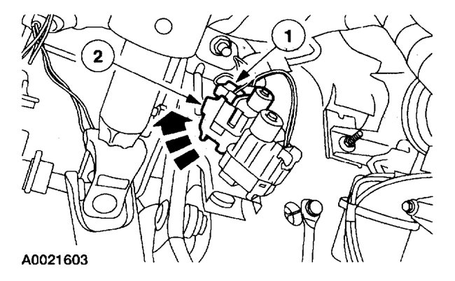

I would disconnect the wiring from the stop light switch and see if the fuse still fails.

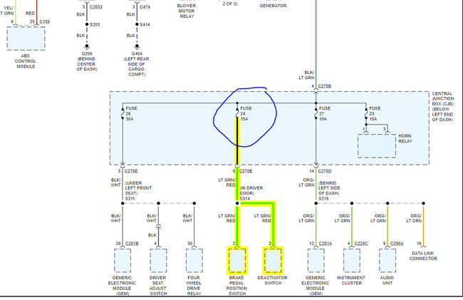

I attached a diagram of the fuse and what it controls.
1. Remove the Brake Pedal Position (BPP) switch.
1 Disconnect the electrical connector.
2 Rotate clockwise and remove the BPP switch.
Nov 7, 2020 at 6:35 AM

Okay, if you disconnected the switch and the fuse still fails, the harness from the fuse to the brake switch is shorted somewhere.
Someone needs to check the harness for damage.

Because there is a short in harness before it reaches the switch.
Between the fuse and the switch, there is a wiring issue that is causing the power wire to be grounded against another wire causing the fuse to fail.

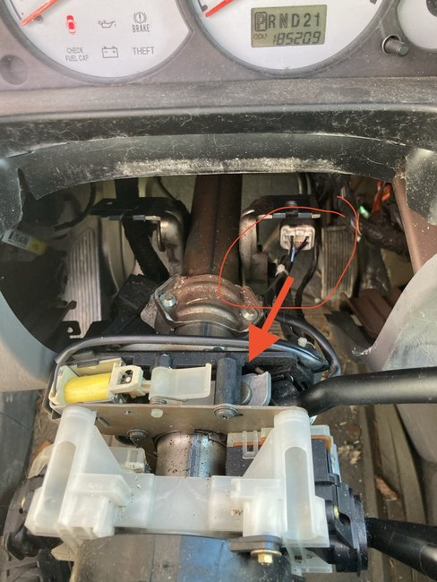

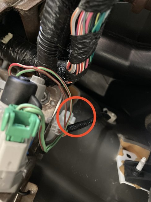

Hello Roy, so there isn’t anything visible that I can see. But I did see this connector I do not know what exactly it is supposed to do, I have a hunch that it’s to the cruise control. But do not know for sure. Any idea off the top of your head?
Nov 9, 2020 at 4:19 AM

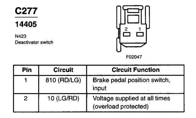

Can you give me the colors of the wires on that connector?
That is not the issue at all.
Nov 9, 2020 at 4:21 AM
DURDELION
  • 9 POSTS
It is not on the circuit. If the fuse still fails then the harness is shorted somewhere between the fuse block and the stop light switch.
