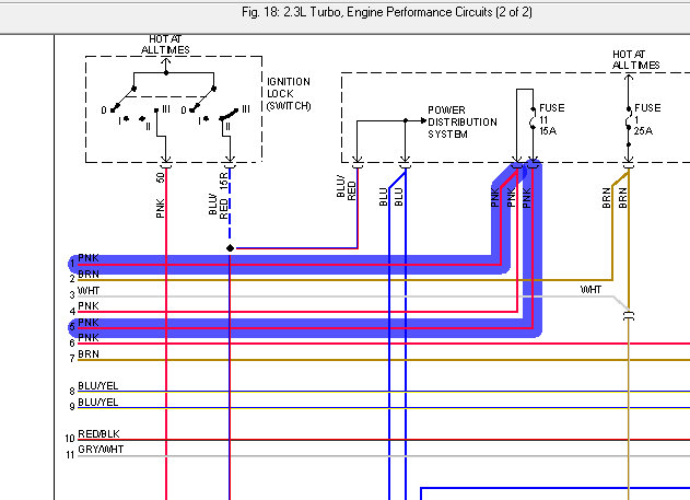

Hi folks:
My car is a turbo. The problem I have is it keeps blowing the fuel pump fuse. I have replaced the fuel pump relay and the fuel pump under the seat, but it still blows the fuse. Is there anything else it could be?
Thanks, Phil

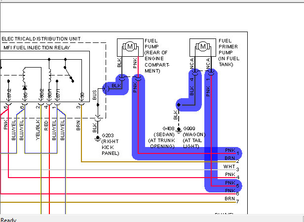

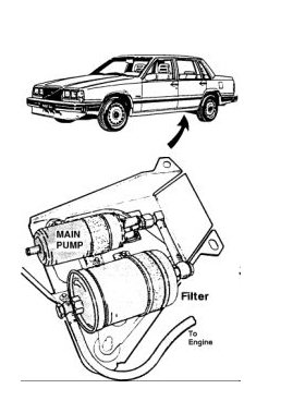

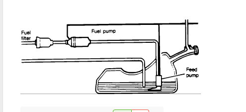

hello,
it seems like you have short in fuel pump wiring system, or the other fuel pump which you don't replaced has internal short, your car has 2 fuel pumps 1 inside the fuel tank and the other is the outside check the diagrams below.
which fuel pump have you replaced?
check our link below how to check the wires:
Check link below how to replace fuel pump.
https://www.2carpros.com/articles/how-to-replace-an-electric-fuel-pump
Check the diagrams below helps you to check the wires.
let us know what happens with you.
