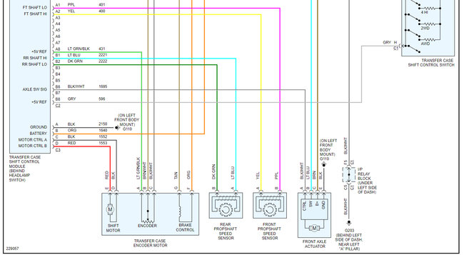

My 4x4 worked when i got the truck a month ago, but here recently just got a "Service 4x4" code show up. I replaced the actuator and then noticed that the 4x4 fuse in the vehicle was blown. As soon as I replaced it, it just kept blowing once I turned the ignition on. Any clues or ideas?
Nov 4, 2020 at 6:52 AM

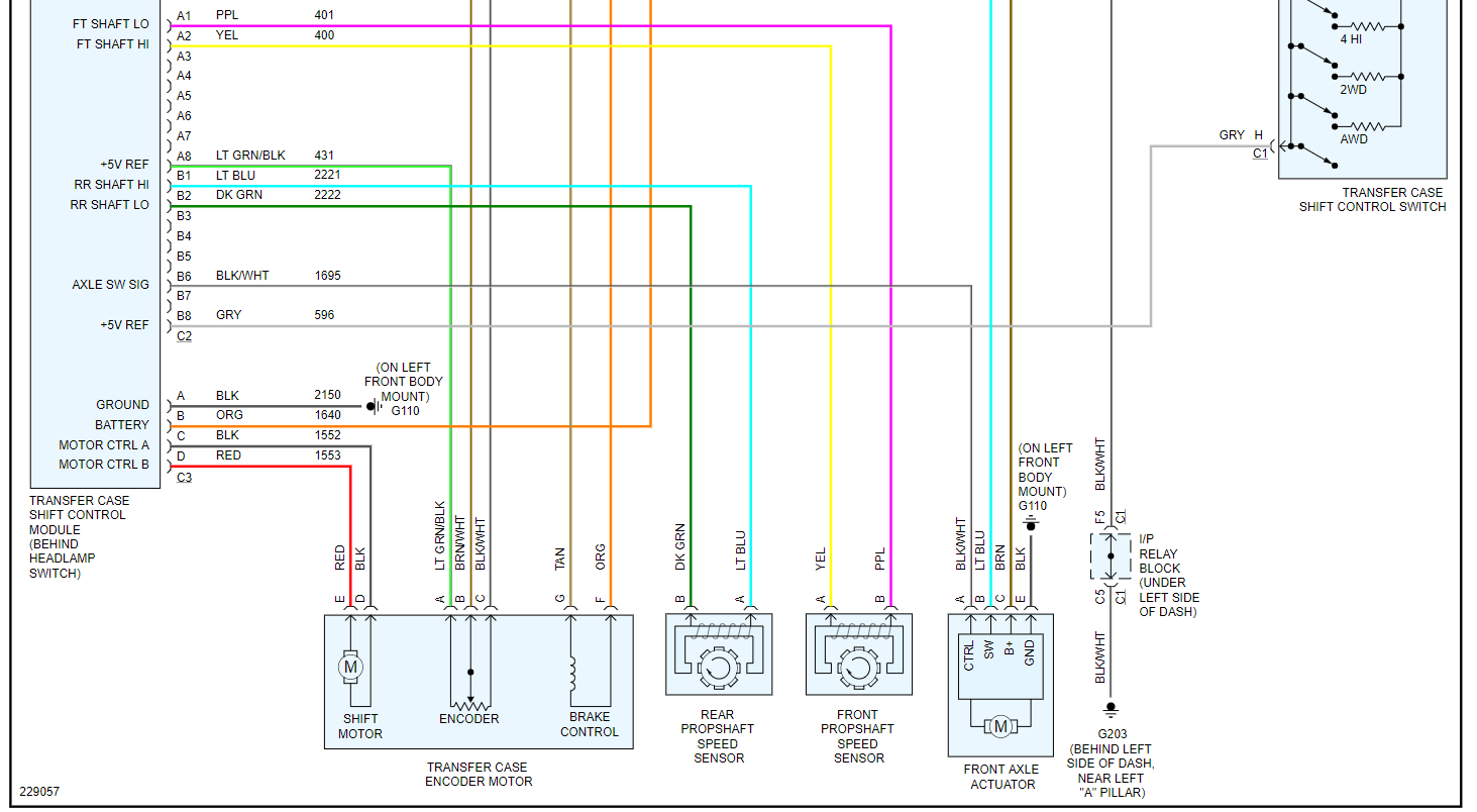

Good evening,
I attached the wiring diagram for you to view.
Can you tell me which fuse fails so I can trace that wiring for you?

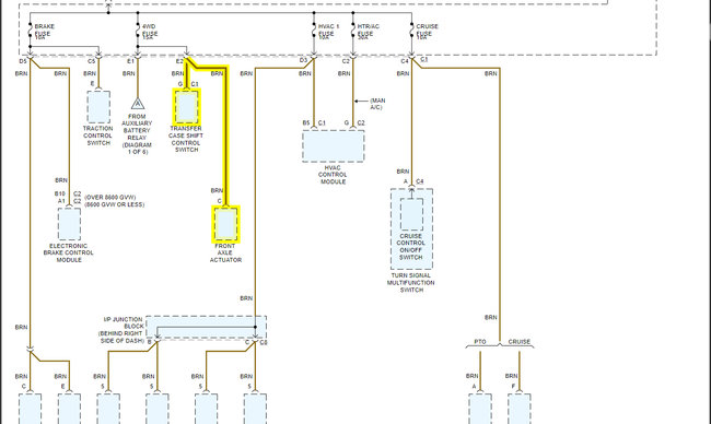

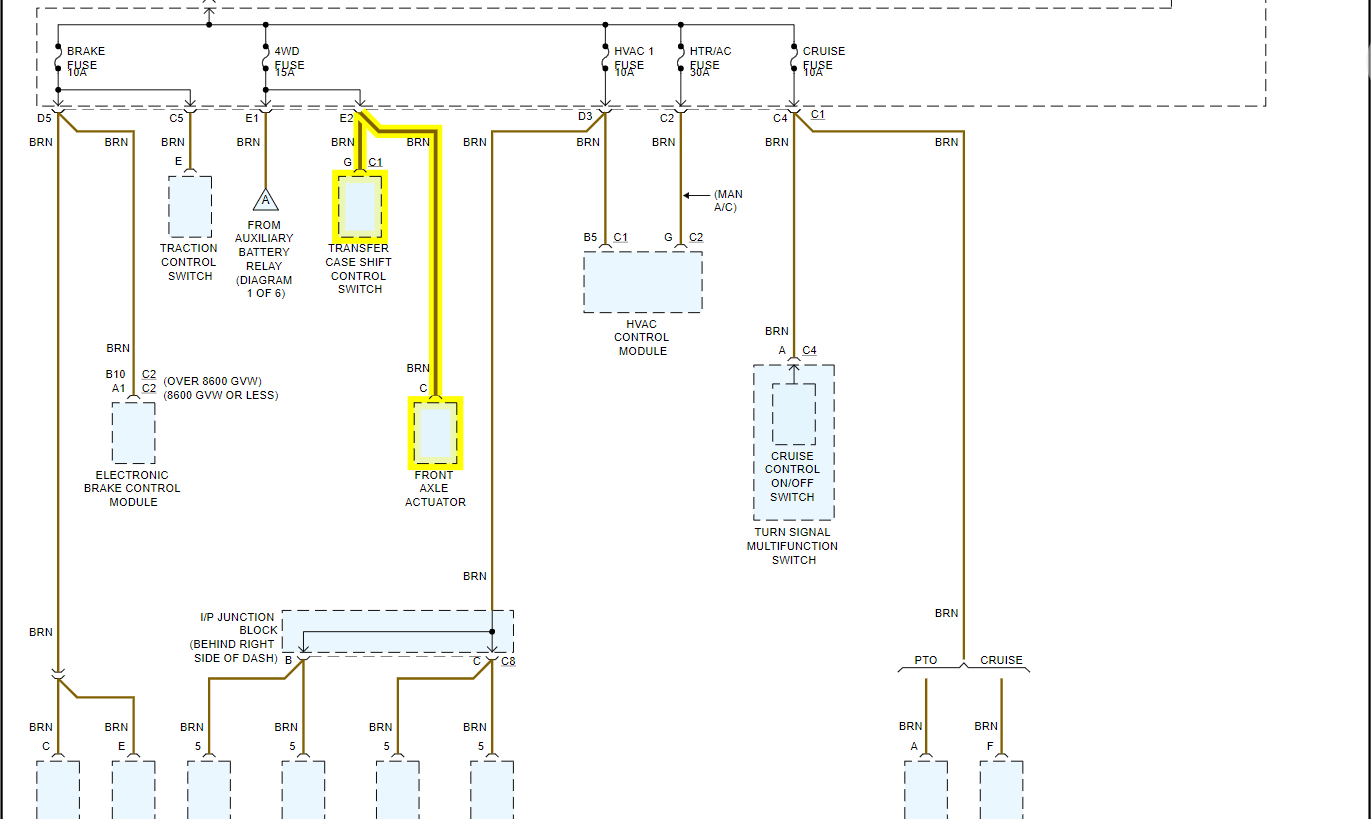

Okay, I attached what the fuse controls.
If you disconnected the switch and actuator and the fuse still fails, the wiring is shorted between the fuse block and the 3 components.

I unplugged the 4x4 selector and unplugeed the plug under the hood for the actuator and it still blew the fuse.
Nov 5, 2020 at 3:06 AM
Okay, as I stated if the fuse still fails it is a wiring issue. The wiring is shorted somewhere after the fuse.
Nov 5, 2020 at 3:14 AM
SCHMIKYL
Are you thinking between the interior fuse panel and the plug of the actuator under the hood?
Nov 5, 2020 at 3:17 AM
Yes, I am. It could be there or to the switch.
Tracing the harness is the next step.
