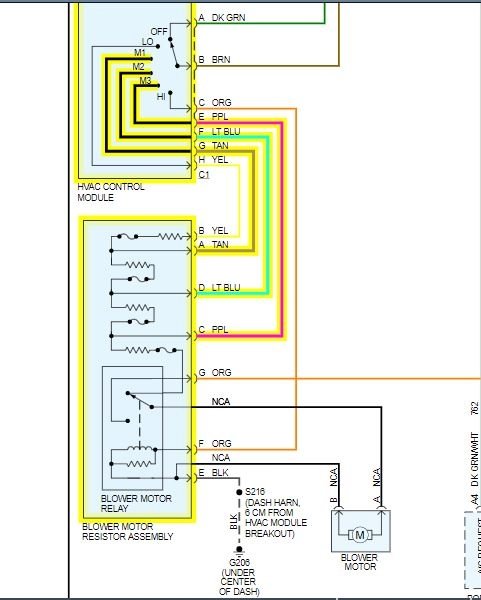

Blower works on one speed only
2001 CHEVROLET MONTE CARLO
305,000 MILES • 3.8L • 6 CYL • 2WD • AUTOMATIC
CJOHNS238
  • 6 POSTS
I have put in 2 different resistors and blower motor. Still no other speeds. At the electrical pigtail that plugs into the resistor those terminals for each speed only have 6.5v. When blower motor is plugged in and you try different speeds the fresh/recirculating button A/C rear def buttons will either not light or half light and won’t turn off until you turn the key off to reset. If motor is not plugged in then no issues turning speed dial or other buttons on HVAC control module.
Any idea’s?

Good afternoon,
I attached a wiring diagram for you to view. You need to test for voltage to the blower resistor from the selector switch. If that is good, then you may have a bad blower relay.

So this is the second new resistor in a row with no change. The voltage at each speed terminal is around only 6v. Shouldn’t those terminals be at 12v? I have heard of the ignition switch being a poss issue, I have jiggled it with no volt change at the plug terminals. I do get 12v on high. So relay there is working.
Nov 26, 2019 at 3:46 AM
The voltage should be 12 volts, not 6.
It does not mean the relay is good at all.
Looks like you need at least the selector switch. Make sure the brown wire going into the selector switch has battery voltage.

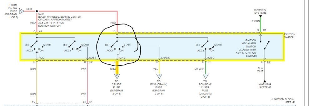

Okay, so the voltage at the plug to the HVAC module is 7.25v... so I am guessing it is the ignition switch?
Dec 5, 2019 at 8:30 AM
Good possibility. check the voltage at the fuse box as well.

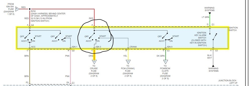

Okay, I pulled out the ignition switch and all the wires had 12v except one. I think it was orange but it showed the same voltage as at the HVAC module.. do you know where I can find a wiring diagram for the ignition switch to the HVAC module etc? Thank you for the continued help!! Oh and what fuse do I check?
Dec 5, 2019 at 9:47 AM
Sorry, sick the past day.
Yes, you need an ignition switch. I attached a diagram for you. That orange wire should have battery voltage on it.
With all the recalls for GM switches, call the dealer and give them your vin number and see if you are in that recall. You could get it done for nothing.

Just finished swapping out the ignition switch and bingo! That was the problem all along!! Thank you for your guidance with figuring this out! Your greatly appreciated!!
