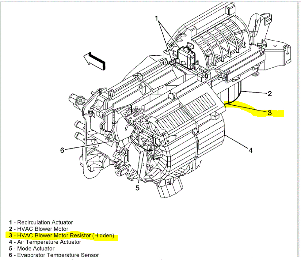

Blower stopped coming on. I took the blower out, hooked it up to a battery and it kicked right on, so that works. I checked all fuses, replaced the relay and heater control switches inside the car and still nothing. I have no dash board lights on, everything electric or electronic in the car works as it should.
I need help and heat. it is cold out there.
Jan 25, 2018 at 7:14 AM
  • 110,236 POSTS
First, confirm there is power to the blower motor resistor (see pic 1). I attached a pic below showing the general. If it does have power, replace the resistor.

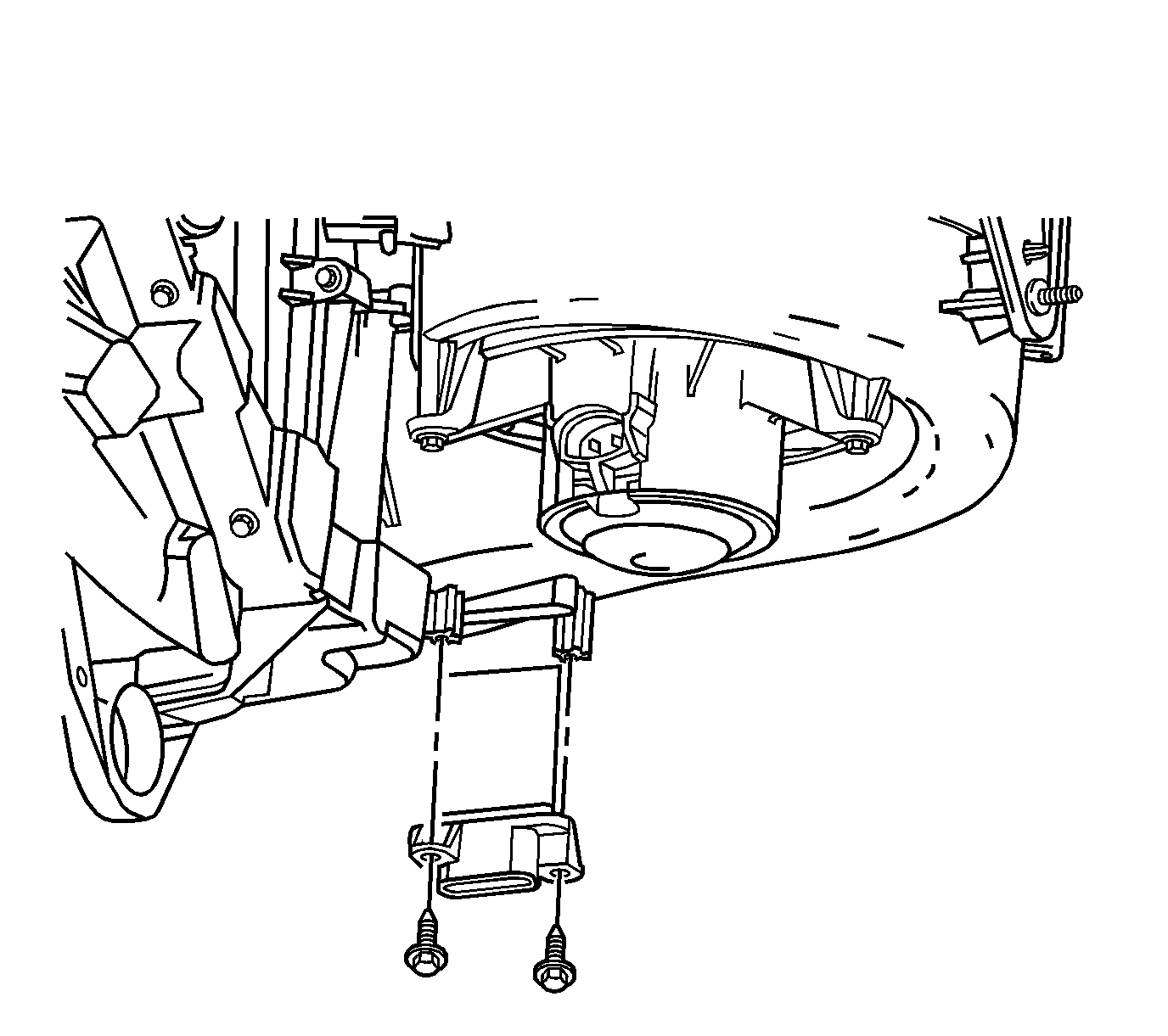

Here are directions for replacing the resistor. The attached pics correlate with the directions.
__________________________________
2006 Pontiac Truck Torrent AWD V6-3.4L VIN F
Procedures
Vehicle Heating and Air Conditioning Blower Motor Resistor Service and Repair Procedures
PROCEDURES
BLOWER MOTOR RESISTOR REPLACEMENT
REMOVAL PROCEDURE
pic 2
1. Disconnect the electrical connector from the blower motor resistor.
2. Remove the blower motor resistor screws from the HVAC module.
3. Remove the blower motor resistor from the HVAC module.
INSTALLATION PROCEDURE
pic 3
1. Install the blower motor resistor to the HVAC module.
2. Install the blower motor resistor screws to the HVAC module.
Tighten the screws to 1.5 N.m (13 lb in).
NOTE: Refer to Fastener Notice.
3. Connect the electrical connector to the blower motor resistor.
