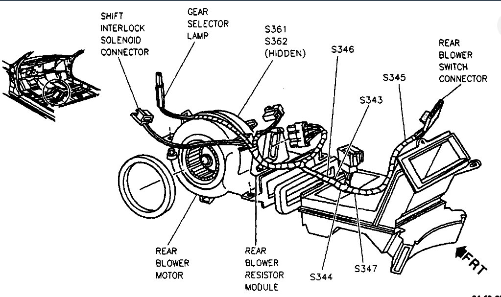

I need to know if 1997 Deville blower has a resistor module and a picture for it? I ordered the part online and it was a module resistor but I can't find it anywhere. I need help. Thank you

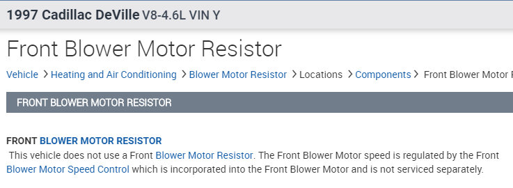

The front blower motor does not have a resistor, However, the rear incorporates a module.. Does this help? I've attached two pictures below for reference. Thanks for using 2CarPros and let me know if you need any more information about this.
