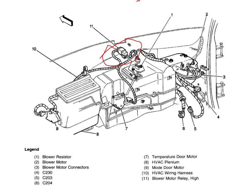

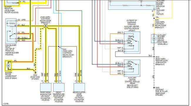

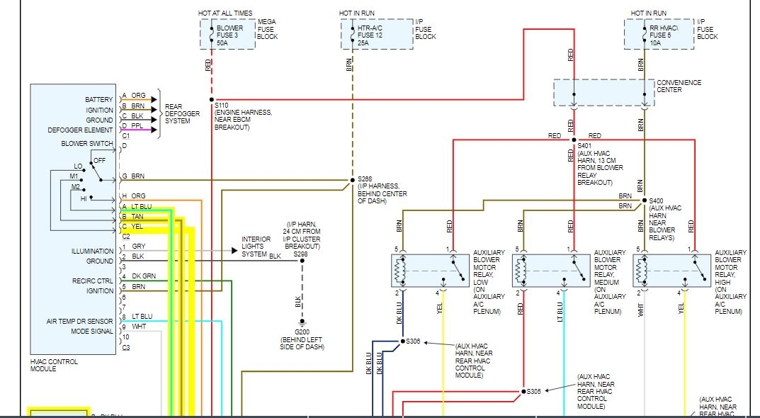

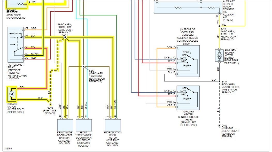

The rear blower won't turn off.
Jan 19, 2021 at 11:50 PM
Good morning,

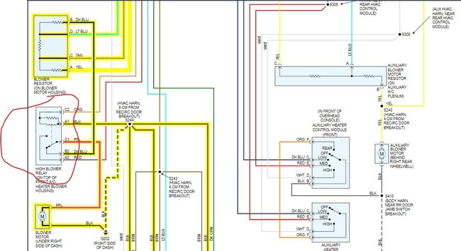

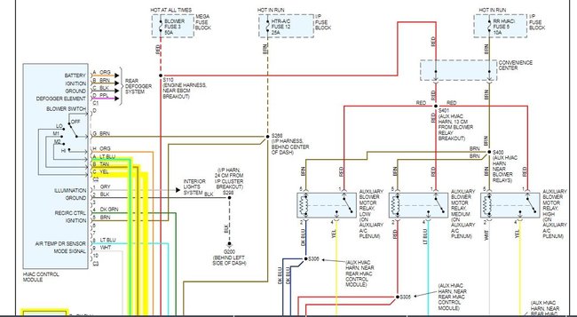

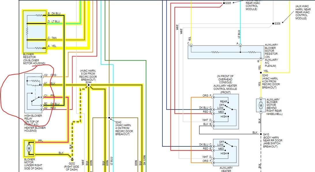

I attached the wiring diagram for you to view. This could be either a bad blower relay or the blower resistor is shorted to power.
Behind the IP compartment box, on the HVAC plenum

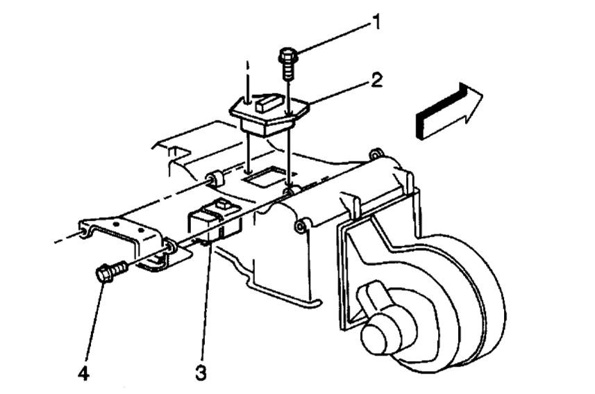

REMOVAL PROCEDURE
CAUTION: Refer to Battery Disconnect Caution in Cautions and Notices.
1. Disconnect the negative battery cable.
2. Remove the instrument panel compartment.
3. Disconnect the electrical connectors as necessary.
4. Remove the relay (3) from the relay bracket.
INSTALLATION PROCEDURE
1. Install the relay (3) to the relay bracket.
2. Connect the electrical connectors, as necessary.
3. Install the instrument panel compartment.
4. Connect the negative battery cable.
5. Test the circuit operation.

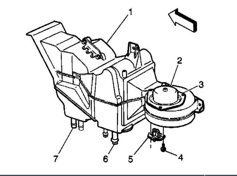

Rear blower resistor
REMOVAL PROCEDURE
2. Remove the right rear quarter trim panel.
3. Disconnect the electrical connectors, as necessary.
4. Remove the screws (4) securing the blower motor resistor (5).
5. Remove the blower motor resistor.
1. Install the blower motor resistor (5).
NOTE: Refer to Fastener Notice in Cautions and Notices.
2. Install the screws (4) in order to secure the blower motor resistor.
Tighten
Tighten the screws to 1.4 N.m (12 lb in).
3. Connect the electrical connectors, as necessary.
4. Install the right rear quarter trim panel.
5. Connect the negative battery cable.
6. Test the circuit operation.
