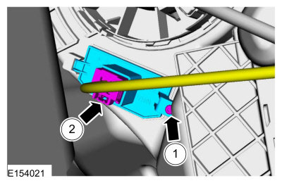

The fan speed only works on number 4. I want to know where the resistor is located. It has manual control. I saw an image of the resistor but do not know where it is located. Vehicle listed above is an S model.
Jan 11, 2020 at 2:59 PM
BMDOUBLE
  • 1,139 POSTS
It is mounted on the driver side of the plenum so you'll need to remove the accelerator pedal. Check out the diagrams (Below). Please let us know if you need anything else to get the problem fixed.

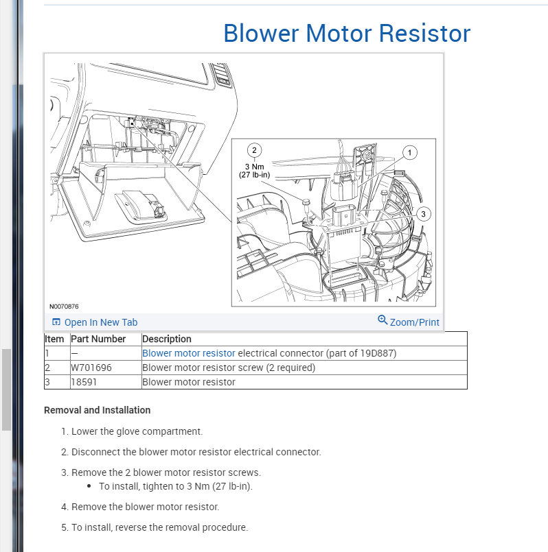

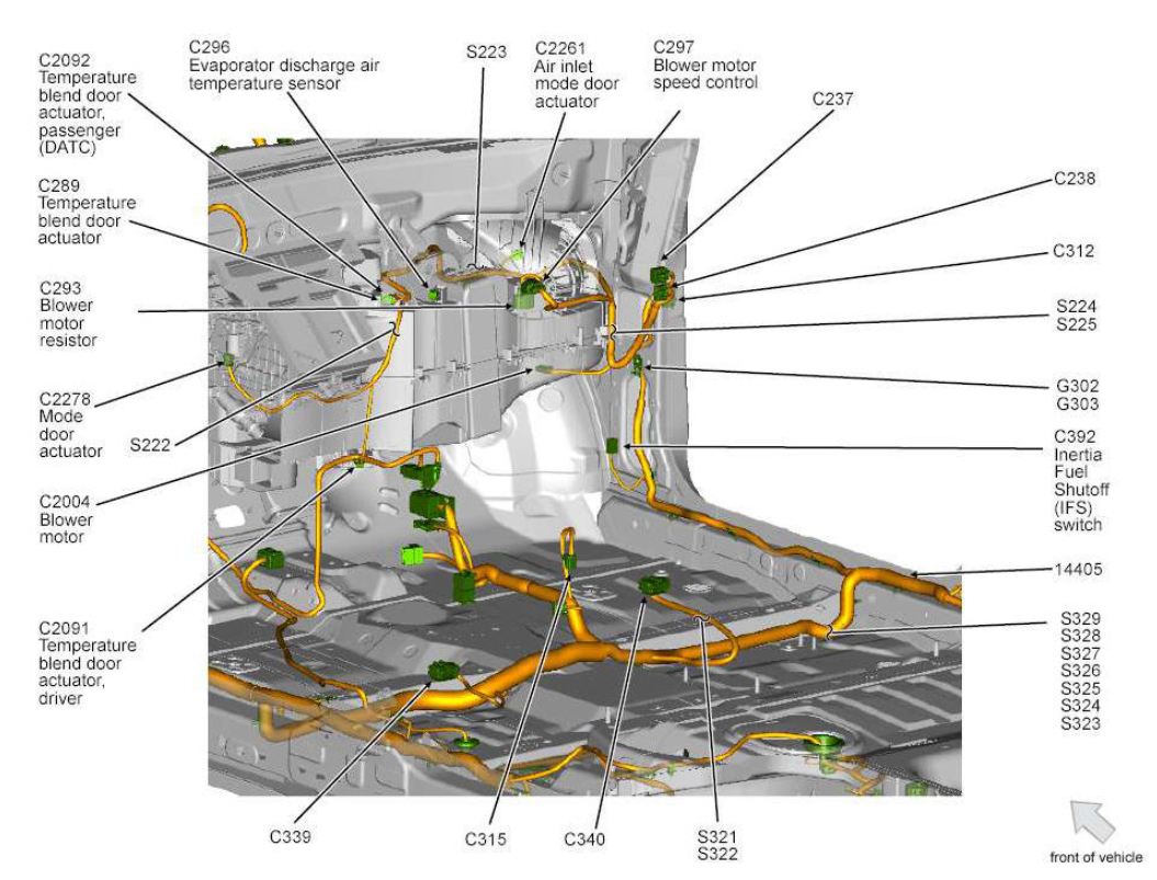

My heat and A/C will only work on level 4, and I think that it is the blower motor resistor. Where is it located so I can replace it?
Oct 5, 2020 at 11:38 AM (Merged)
DRCRANKNWRENCH
  • 3,380 POSTS
It is on the right side of the dash. See attached.
I am attaching the instructions on how to replace this in the event that you are not able to find it. This will show what needs to be removed to access it. Let us know what else you need or how you make out. Thanks
