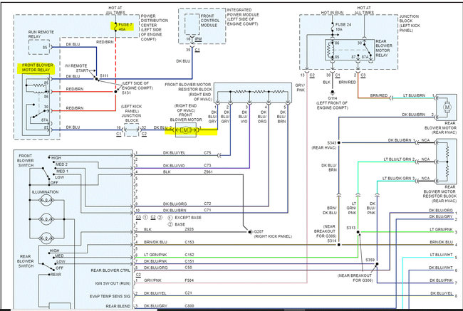

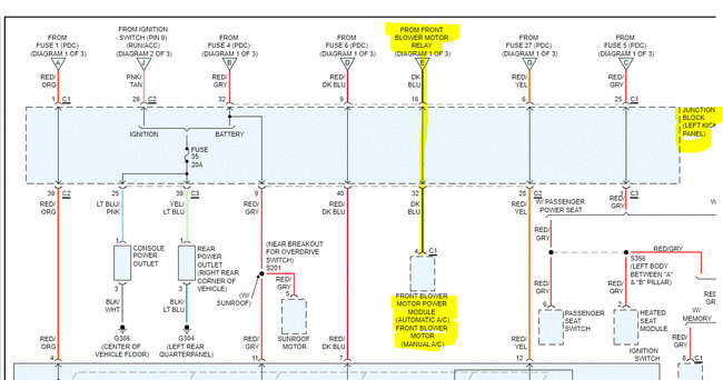

We need to get you heat. If you look below, I attached a wiring schematic of the circuit. It was 2 pages long, but I had to cut it in half to make it readable. I did overlap them and highlight what I need you to check.
First, fuse 7 in the under-hood fuse box I need to be rechecked. First, confirm it is good. Also, it is important to make sure there is power to and from it as well. You could have a good fuse and not power to it. Here is a link that explains how to check:
If the fuse is good and has power, I need you to locate the blower motor relay and see if it is good. If there is another relay having the same part number, switch them. If there isn't, here is a link that shows how to test a relay.
Do this and let me know what you find.

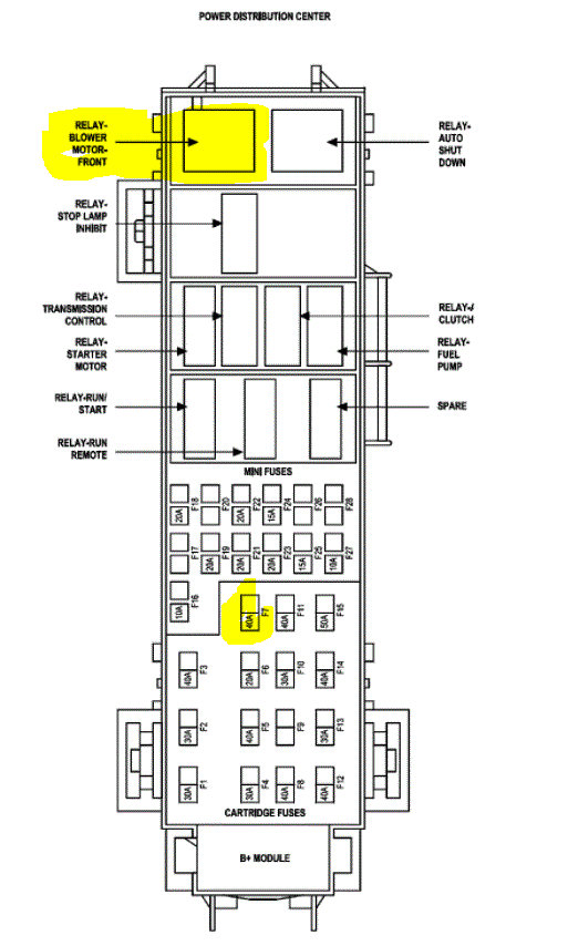

See pics below. The last pic shows the relay and fuse to check.

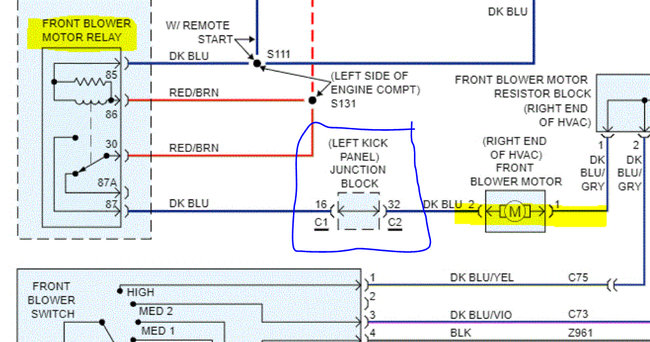

The power runs from the fuse to the relay, to the blower motor, then the resister, then the control switch, which provides a ground path, completing the circuit. We need to determine where it is lost when not working.
The one thing that comes to mind is the temperature you mentioned. Keep in mind, the colder it gets, the more metal contracts. As it heats up, it expands. We have a loose or poor connection at some point.
You mentioned there is no power at the blower motor when this happens. If you look below, I circled a connector at the left kick panel fuse box where power from the relay jumps from one connector to another. I need you to locate the dark blue wire that powers the blower motor and trace it to that connector. Check both sides of the connector/wire for power. Or locate the dark blue wire at the relay and see if power is present. Since you have already checked power at the fuse and relay and it was good, I have a feeling you will find the dark blue wire is not making contact at the connectors/fuse box. Chances are at that point, there is either corrosion, a loose contact, or one of the pins has been damaged.
Please keep in mind, this is a theory at this point, but if there is power out from the relay, the first suspect is the connectors at the junction block that is preventing power from making it to the blower motor.
Let me know if this helps and what you find.

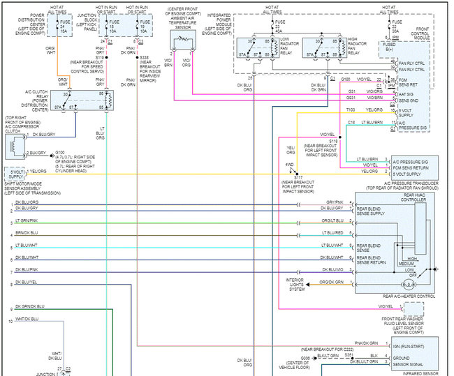

I'm not sure which wire you are referring to. The one that runs from the relay to the motor is grounded via the switch in the vehicle. If you ground it, there will be a short and it will cause fuse 7 (40 amp) to fail in the under-hood fuse box. That needs grounded through the switch. If it is a different wire, let me know which one you are referring to. However, I just looked through the ground distribution schematics and all grounds are either black or have black as a primary color with a tracer color.
If you look below, it shows the wires I mentioned going through the junction box. Neither runs directly to the ground. Take a look at pic 2 and tell me which wire you are referring to. If you have manual climate control or automatic control.
Also, tell me exactly where the test light was connected in the circuit and what you used as a ground.
You are certainly on the right track. It sounds like a loose/poor connection affected by temperature.

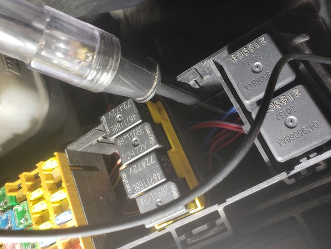

I'm talking about a wire that the relay plugs into, there is a thicker blue wire and a skinny blue wire that comes out of the bottom of the relay, when I tested the skinny blue wire with the test light the blower kicked on.
Dec 13, 2021 at 11:55 AM

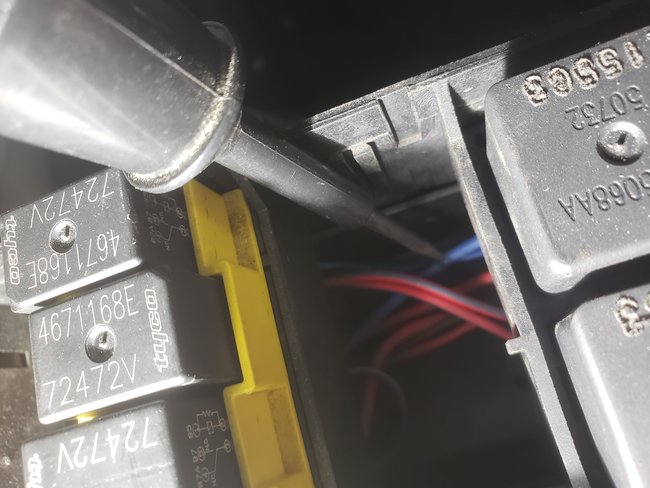

SHYLA23
  • 11 POSTS
This is the wire.
Dec 13, 2021 at 4:25 PM

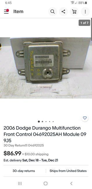

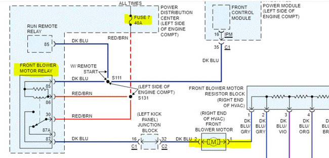

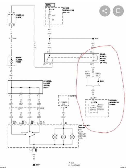

Here's the diagram with what I believe is the problem circled, I can't find a front control module anywhere in the IPM fuse box..
Dec 13, 2021 at 10:39 PM
SHYLA23
  • 11 POSTS
Unless it is this thing? All the connections look good on mine I cleaned them all as well.

That is where I'm getting confused. The heavier gauge wire should go to the blower motor and the smaller one to the relay. If you ground the smaller one before the relay, power won't make it where it needs to be.
Could the blower motor have turned on simply because you moved the wire around?

According to the diagram the smaller wire should go to the front blower control in the IPM, the picture of the relay isn't a very good representation, there are 2 red wires going into the back of the relay and the thicker blue wire and smaller blue wire come out as well, when I ground the smaller blue wire the relay clicks and the blower starts working, I setup a ground switch off the small wire so I can override the problem for now, as long as I turn the switch off every time I should be fine.
Dec 14, 2021 at 9:45 PM
  • 110,248 POSTS
As long as it's working for you, that's a good thing. LOL Are all speeds working as well? And yes, the smaller blue should go to the front control module. I went through schematics again and now have a better understanding of what you are seeing. The module provides the ground for the relay. Ugh!!! I wish they would make one schematic for one model of vehicle. LOL
Regardless, the ground is the issue. Either the module is bad or the ground to it is bad. No matter what, you got it working and that's what's important.
