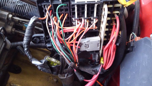

SUV listed above two door with a 4l60e transmission.
Two years ago put on all new A/C under the hood and new climate control module in the dash. with in a year the high fan control setting stopped working. I waited until now to resolve it as I was going to change the engine.
So I replaced the dash environment control module switch. I replaced the A/C box resistor. Tried the unit still not running on high.
I then replaced the Fuse box relay and the relay that sits beside the resister under the dash. Still does not run on high switch setting.
I spoke to several mechanics they said there is a fuse in the fuse box under the hood that powers the high setting. Turns out inside the lid there is a listing for a fuse but this SUV simply does not have that fuse equipped in there. Not sure if they changed the set up from 1998 and a half through 1999 and a half but that is what i am looking at. The vehicle is stock.

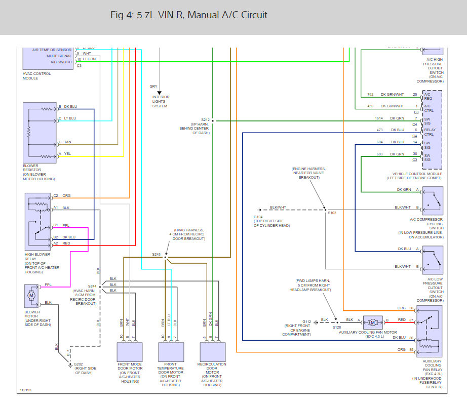

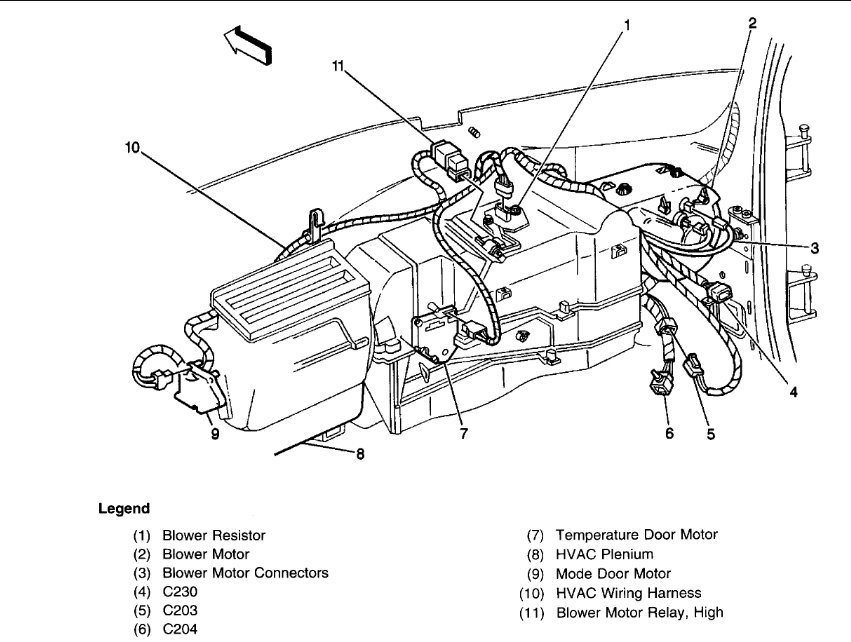

There is a blower motor relay for the 'high' setting. Have you checked/replaced? Here is a tutorial on how to test:
It's attached to the HVAC unit under the dash and I've attached a picture below of its location (#11). Hope this helps and thanks for using 2CarPros.

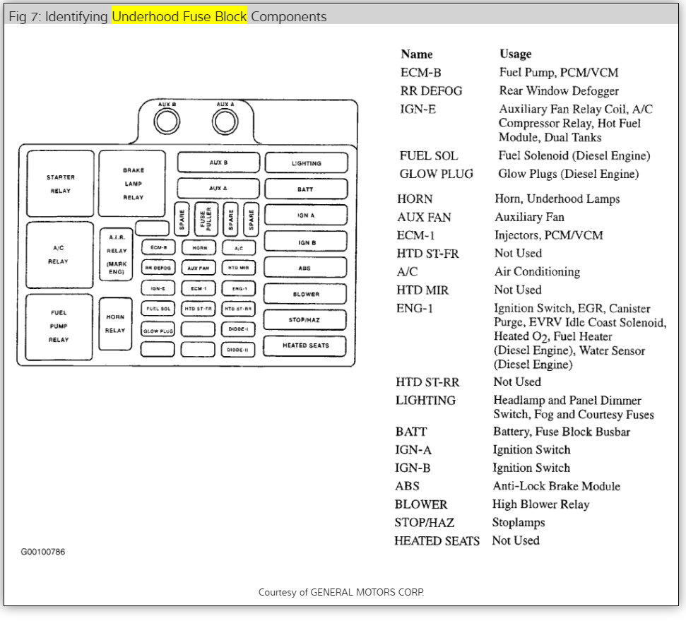

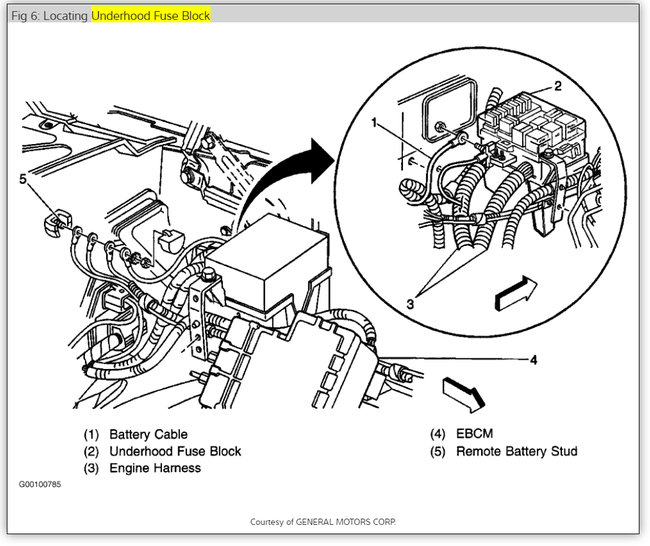

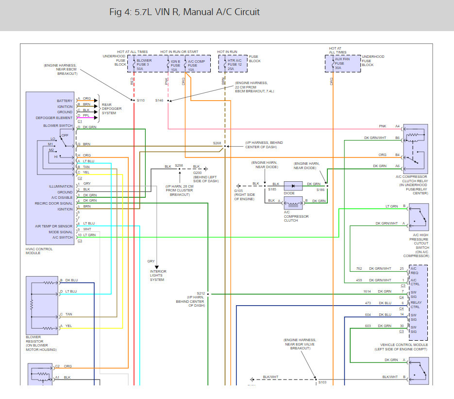

Sorry for the misunderstanding. Lets test for power at the blower fuse #3. here is the fuse location and and guide to help you test with the blower motor wiring below so you can see how the system works:

Hello, my fuses are fine checked them, but my fuse block isn't set up in this manner.

Do you have power at the red wire at the high speed relay?

can you unplug the high speed relay and jump the red with the purple wire on the connector with the key on to see if the blower runs?

Ken: When I try to jump the red to purple wire nothing happens. I had just put in a new switch inside the control module. I can only assume the new switch is defective?

Do you have power at the red wire? use a test light to see.

25 volts? the system has 12? Can you use a test light and if it lights up you have power the fan should run if not check the ground.

Ken. Relay model out key on switch on high no power to red. Orange wire only light comes on.
May 20, 2019 at 8:31 AM
  • 55,628 POSTS
The red wire needs power. did you check the 50 amp fuse under the hood?

So you have power at the fuse but not the wire? the fuse powers the wire so you must have a bad connection,l use the test light to see where the power stops.

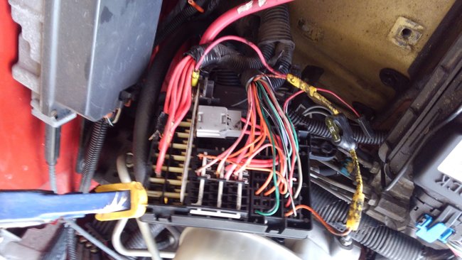

Ken: I found something really Bizzar, a rigged wiring fuse inside the fuse box with a 30 am fuse. Is there a way I can send you a picture of this?
May 21, 2019 at 9:34 AM
NATHANHANOVER
  • 23 POSTS
I found the up links.
May 21, 2019 at 9:39 AM
NATHANHANOVER
  • 23 POSTS
Found it. This connection clip is faulty.
May 21, 2019 at 10:41 AM
NATHANHANOVER
  • 23 POSTS
The clip that connects the red wire, power wire under the dash is / was faulty.
