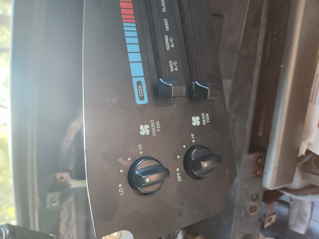

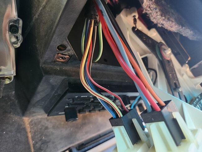

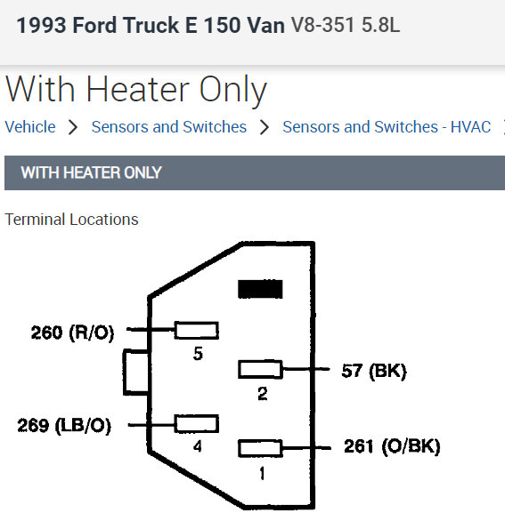

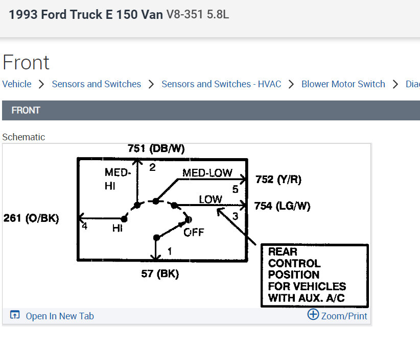

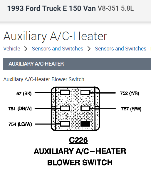

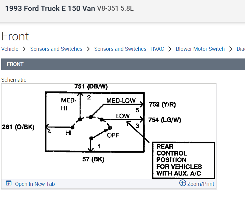

I need to place new connectors to my two (front and rear) blower motor selection switches on the dash. Does anyone have a diagram of the connectors and where each color wire goes?
Oct 11, 2024 at 3:32 AM
  • 55,447 POSTS

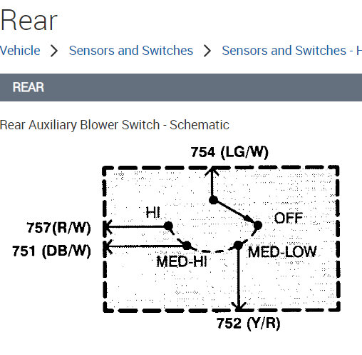

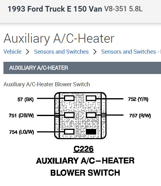

Sure, here are the connectors and wiring diagrams to help you repair the wiring. Check out the images (below). Let us know if you need anything else.

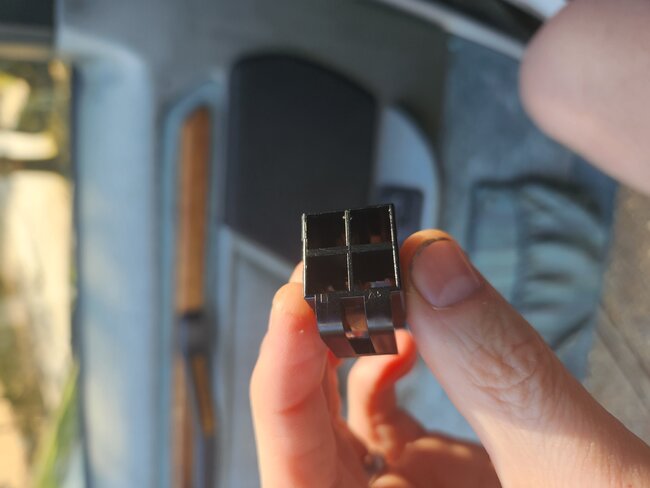

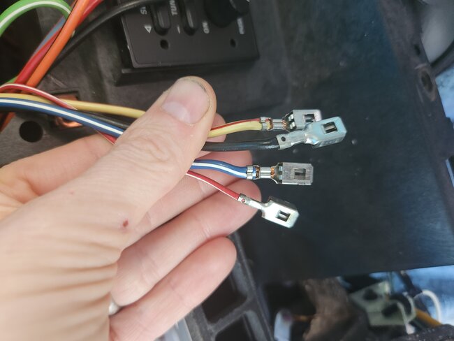

Appreciate the diagrams; however, both of my connectors only have 4 wires. They are both square shaped, similar to the one in the first image (but with only four holes). Do you happen to have any schematics of that type? Thanks
Oct 11, 2024 at 5:08 AM
ERICH PETERSON
  • 36 POSTS

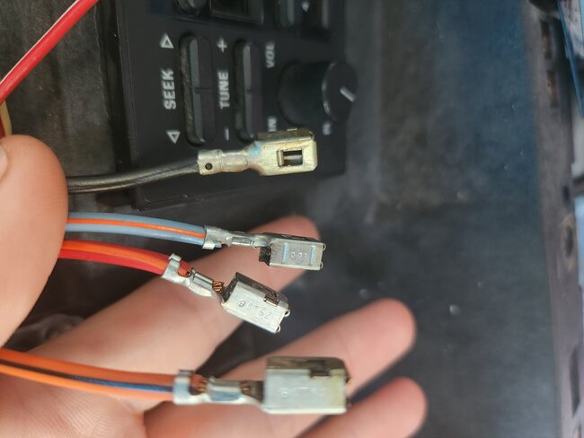

Here is a picture of the connector and the two sets of 4 wires I have. There is a green with white strip that is packaged with the second set of wires shown, but it is taped up.
Oct 11, 2024 at 5:47 AM
ERICH PETERSON
  • 36 POSTS
Update: I was able to figure the correct order via trial and error. Here is a photo of the final configuration in case someone has the same question.
