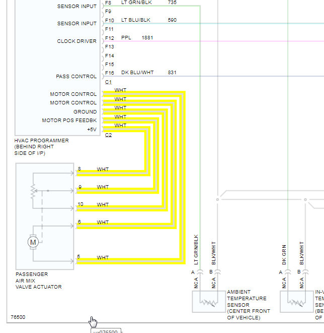

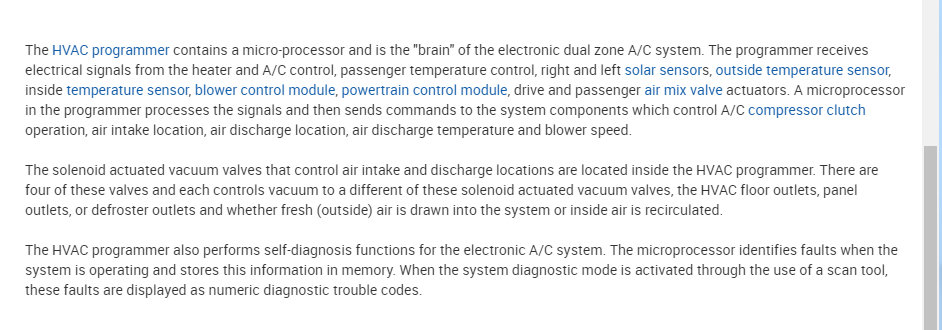

This is one of two things. First, you have a shorted wire causing the fan to remain on. Second, the HVAC programmer has failed causing the blower motor to remain on. I attached detail on this system but basically the programmer controls this motor and if it is shorted it will keep the blower on all the time.
The fact that you are pulling the AC relay out just shows that the programmer is most likely the issue because you are removing power from it. If the wiring was shorted then it would most likely remain on due to it still getting power from the short.
If it were me, I would simply measure voltage coming out of the programmer when the engine is off and the fan is still on and see where the power is coming from. Then check that wire for a short just to confirm it is okay and then replace the programmer.
