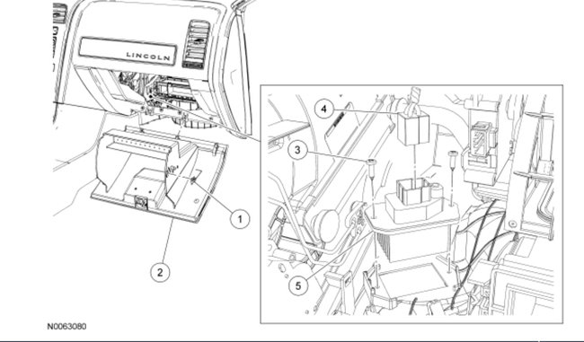

Here are directions for resister replacement. The attached pics will correlate with the directions.
___________________________________
2010 Ford Truck Edge FWD V6-3.5L
Blower Motor Speed Control
BLOWER MOTOR SPEED CONTROL
412-01 Climate Control 2010 Edge, MKX
REMOVAL AND INSTALLATION
NOTE: Blower motor speed control shown, blower motor resistor similar.
Pic 1
Item Part Number Description
1 7806200 Glove compartment damper
2 7806024 Glove compartment
3 — Blower motor speed control screw (2 required)
4 19C603 Blower motor speed control electrical connector
5 19E624 Blower motor speed control (Electronic Automatic Temperature Control (EATC) vehicles)
5 19A706 Blower motor resistor (Electronic Manual Temperature Control (EMTC) vehicles)
Removal and Installation
Detach the glove compartment damper from the glove compartment.
Remove the glove compartment.
Disconnect the blower motor speed control electrical connector.
Remove the 2 blower motor speed control screws.
Remove the blower motor speed control.
To install, reverse the removal procedure.

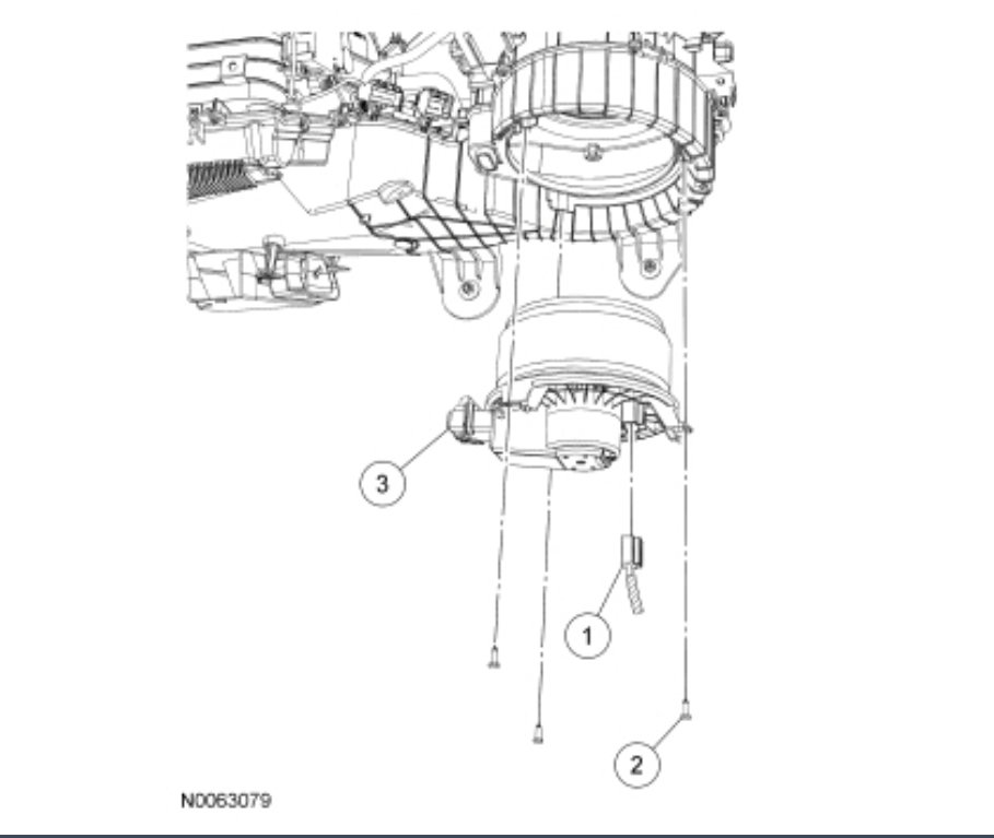

If you find the motor is bad, here are the directions for replacing it. Again, the pics will correlate with the directions.
________________________________________________
Blower Motor
Vehicle Heating and Air Conditioning Blower Motor Service and Repair Removal and Replacement Blower Motor
BLOWER MOTOR
Blower Motor
pic 2
1 19C603 Blower motor electrical connector
2 — Blower motor screw (3 required)
3 19805 Blower motor
Remove the RH lower instrument panel insulator.
Disconnect the blower motor electrical connector.
Remove the 3 blower motor screws.
Remove the blower motor.
