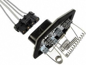

We do not have access to parts numbers like the one you posted since Duralast is an Autozone part number. You would need to call the dealer to get the part number and have Autozone cross reference that number. On my side for the vehicle you have posted OE number comes as 15039098.
It would be much easier to profile the vehicle by VIN number but that is the information I have for a 2000 Chevy K1500 Tahoe with a 5.7L engine and part comes up as the picture shown below. Also I believe it makes a difference if you have A/C or no A/C.

The vin you gave me shows the resistor is correct. GM part# 15039098. So the dash needs to be pulled back to look at the connectors and check the blower relay.
