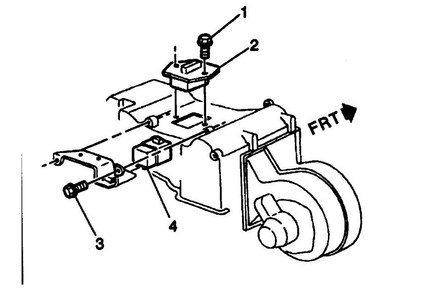

Could you tell me a round about location of the blower motor resistor?

Good afternoon,
It is on top of the plenum by the blower motor. I attached a picture and the procedure for you to view.
Remove or Disconnect
1. Negative battery cable.
2. Roll instrument panel back.
3. Plenum tray.
4. Electrical connectors, as necessary.
5. Screws.
6. Blower motor resistor.
Install or Connect
1. Blower motor resistor.
2. Tighten screws to 1.9 Nm (17 lb in).
3. Electrical connectors, as necessary.
4. Plenum tray.
5. Roll instrument panel forward.
6. Negative battery cable.
- Check circuit operation.
