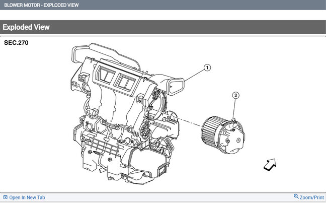

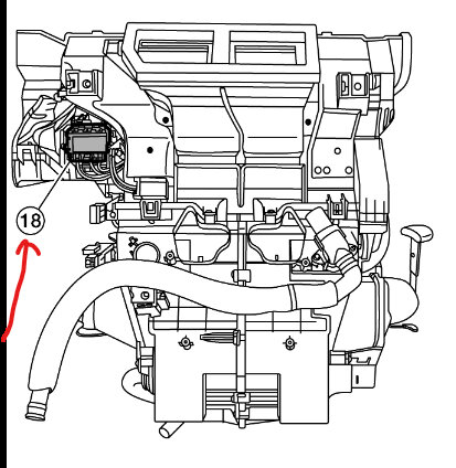

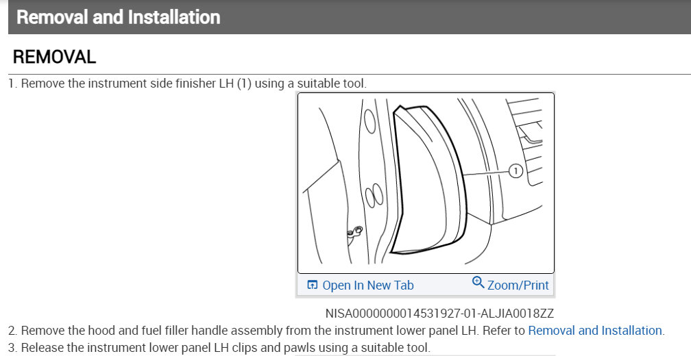

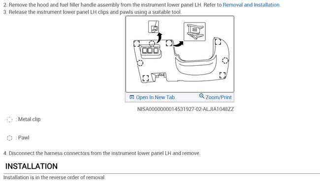

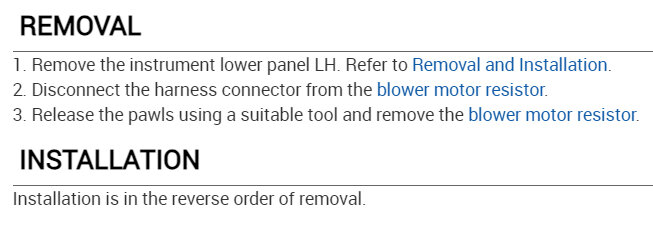

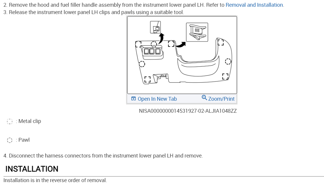

Where is the blower motor resistor located?
2019 NISSAN SENTRA
21,000 MILES
CREE1138
Aug 29, 2023 at 11:46 PM
  • 55,433 POSTS
This car has a Variable blower control which does the job of the blower motor speed resistor. Here are the instructions on how to change it out along with the location. Check out the images (below). Please let us know what happens.
