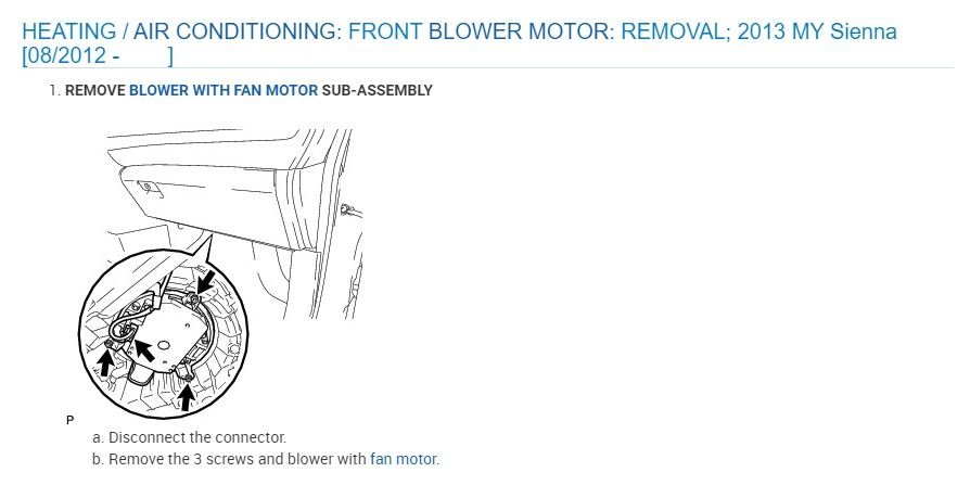

The front blower motor went out on my van. I replaced it and it worked for about 6 months then went bad again. I bought a replacement that was rebuilt and cheap. I thought maybe it was a case of you get what you pay for. I spent more money and got a quality blower fan. Worked great until 6 months later. It has stopped working. What is causing me to burn through blower motors?

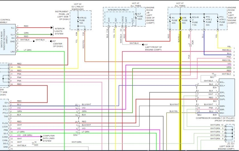

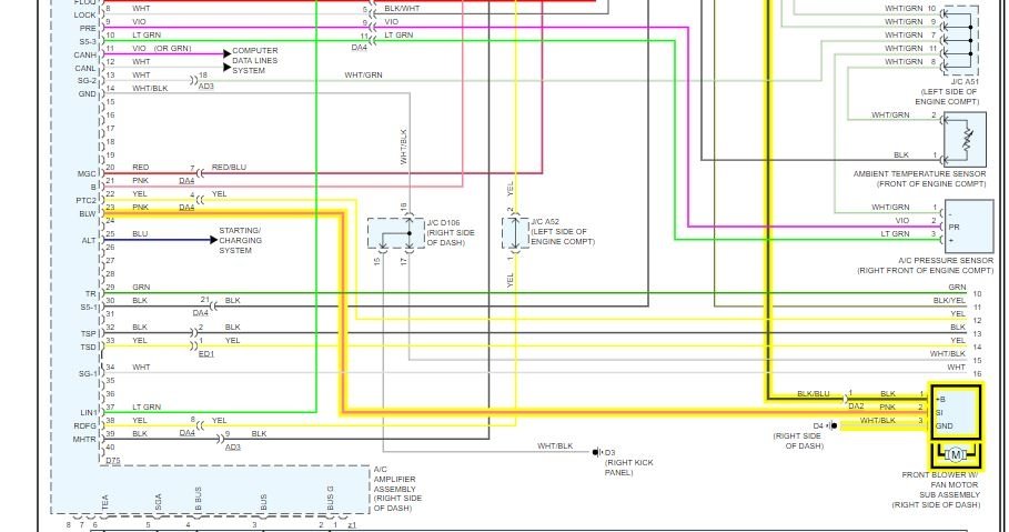

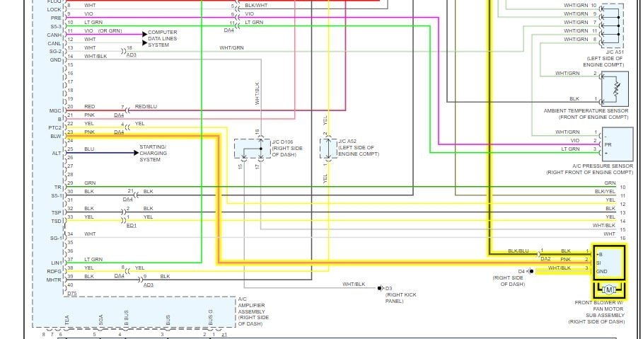

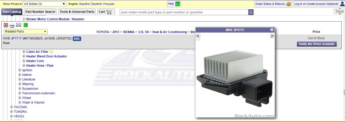

Did you replace both the blower and the resistor or just the blower?
what brand did you use for the blower motor?
I would replace the resistor as well. It is common for causing premature failure for the blower.
