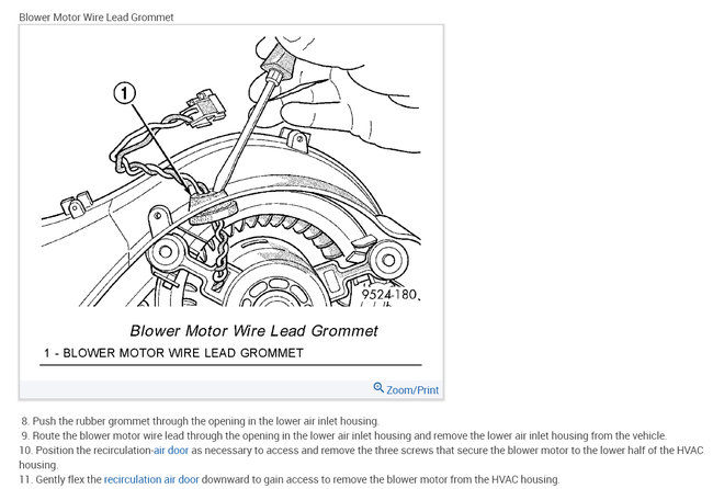

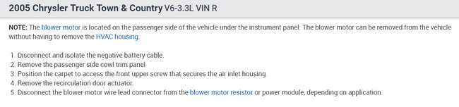

I checked fuse replaced relay and resistor blower still doesn't work. Going to replace blower. What is easiest and best way to remove blower on 2005 Chrysler Town and Country?
Jan 14, 2016 at 7:00 AM
CATAFINA
  • 167 POSTS

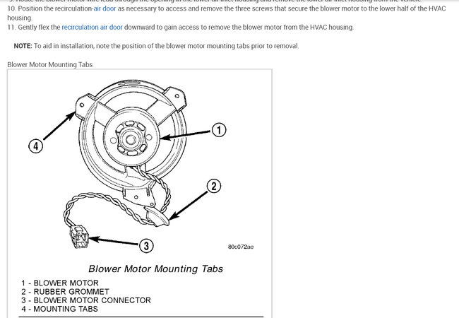

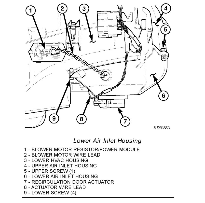

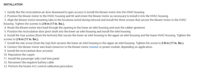

Here is a guide to show you kind of what you are in for with diagrams below to show you exactly what to do please go over both before you begin.
https://www.2carpros.com/articles/blower-fan-motor-works-on-high-speed-only
