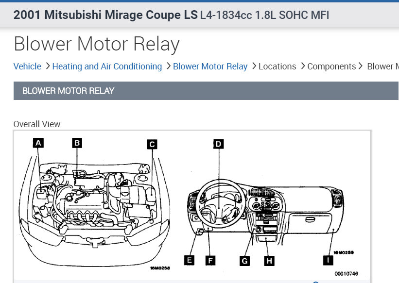

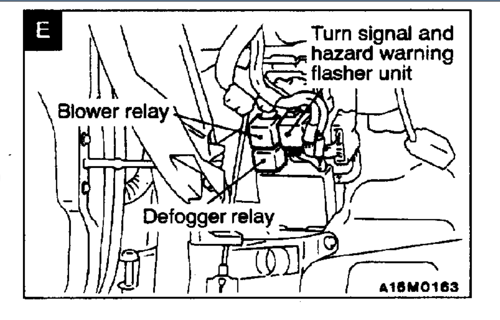

I just want to know where is the blower motor relay located at.. Thanks

I have included the information that you requested in the diagrams down below. Please get back to us with how everything turns out and I hope this helps.
