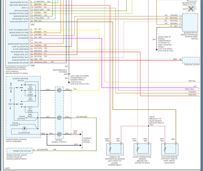

Just recently I noticed that my front vents have stopped blowing any air. I can't use the defrost, A/C or heat. The digital control still works and if I have the A/C turned on I can feel a little bit of air coming from the vents while driving, but that stops when I brake. The odd thing is that my rear vents work just fine, on low, medium or high. They also blow hot or cold air depending on how I have the temperature set on the front control unit. I don't know what the problem could be.

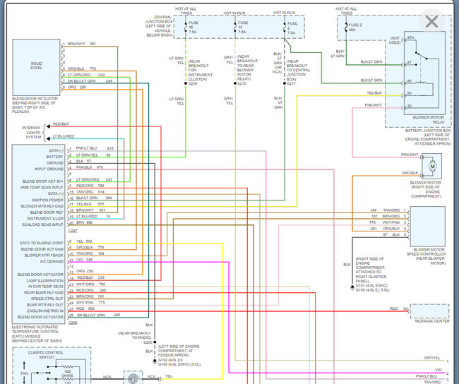

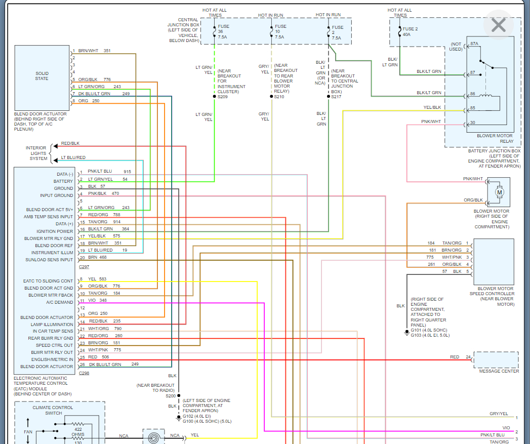

When you are not getting air coming out, let's go to the blower motor and check the voltage on the fan when it is on high. If it is 12 volts then the fan motor is the issue.
If it is not then we need to go back in the system to find out what the voltage is at the relay and then the resistor which is on the ground side and called the speed controller on the wiring diagram below.
Please run through this and let us know what you find and we can go from there.
