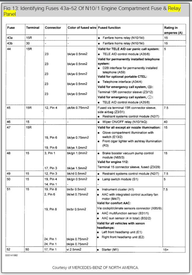

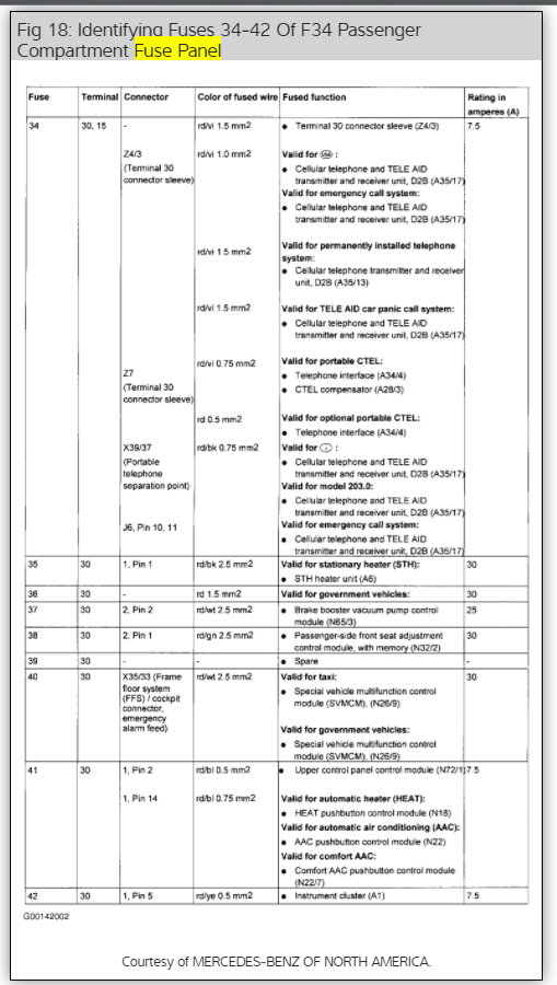

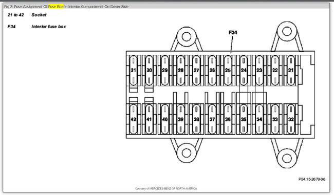

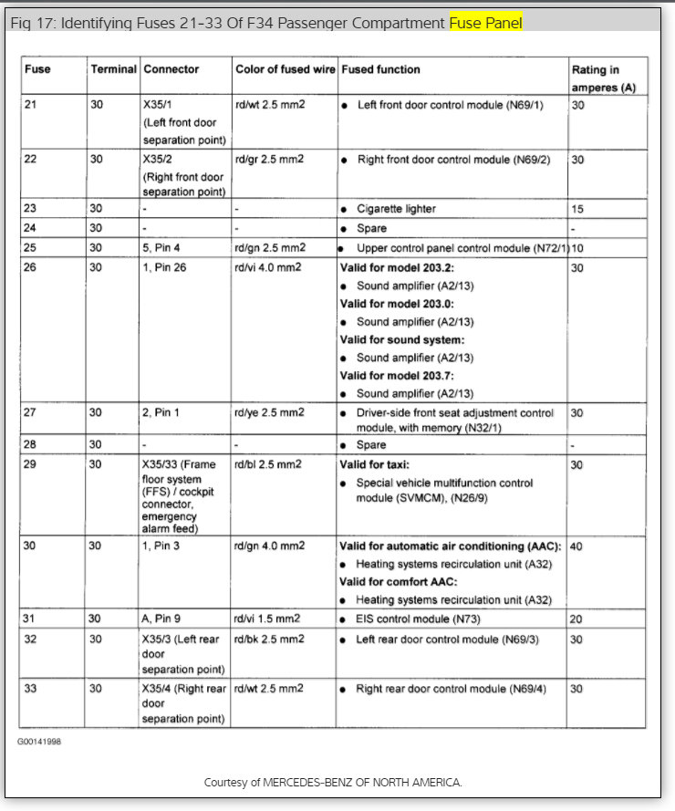

That is weird. I would check the other system fuse #41.
Here is a guide:
Other than that you must have an open wire/connection somewhere.

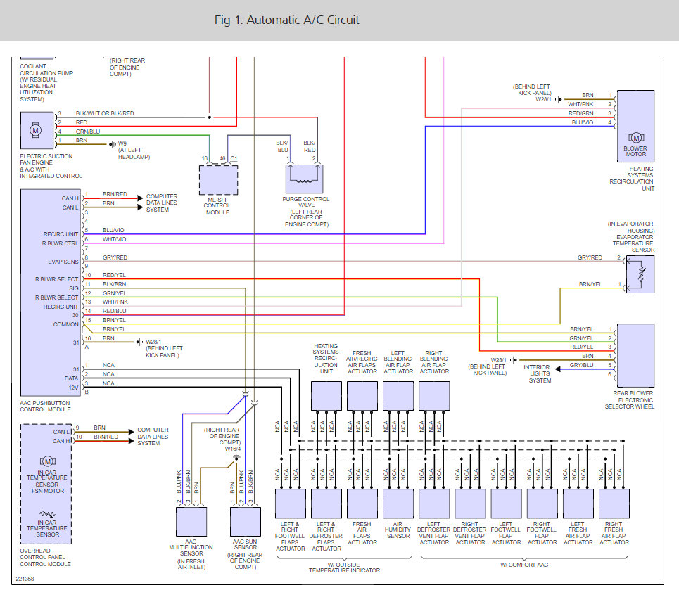

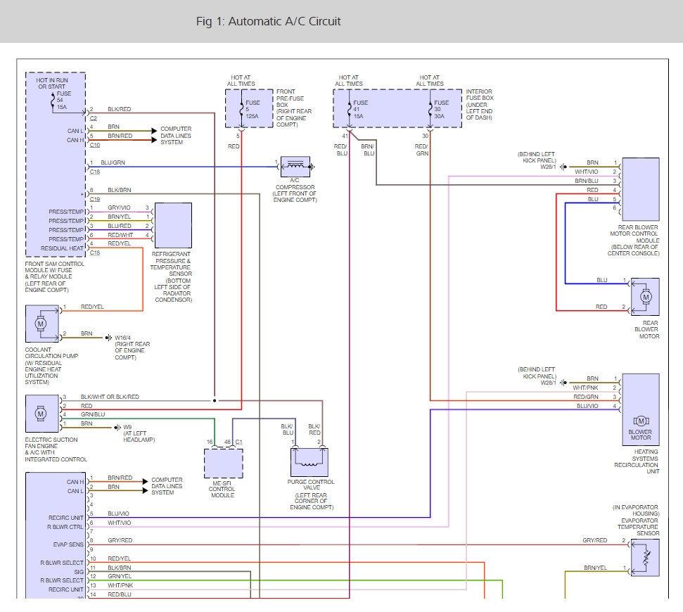

Here is a guide and some wiring diagrams for the blower motor so you can do some testing:
Oct 13, 2017 at 4:24 AM
TRELLABOR
Hi Ken, thank you for replying so quickly. I agree it is very strange, I went ahead and checked fuse #41 and the 15A fuse is in working condition which leaves me with a short somewhere it seems. If I am reading the wiring diagram correctly, there does not appear to be any high-speed bypass connection from the HVAC head unit to the motor directly? Another weird thing is that when the car is off and key out, you can press the AC REST button and the blower will come on at a very low speed as you would expect.
Oct 13, 2017 at 8:10 AM
  • 55,808 POSTS
The AC power controller is the only other thing that runs the system if you unplug it does the fan motor stop?
