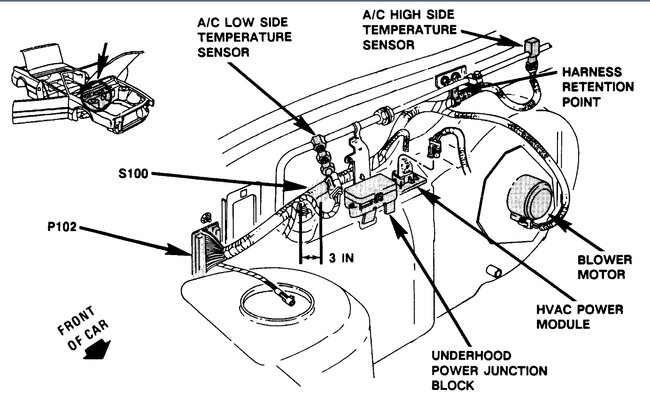

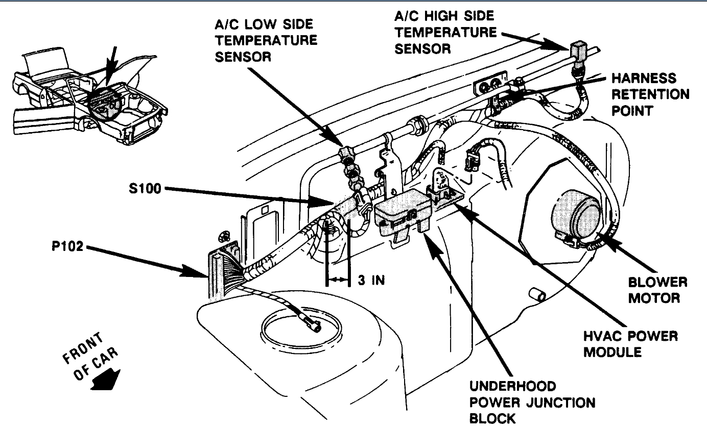

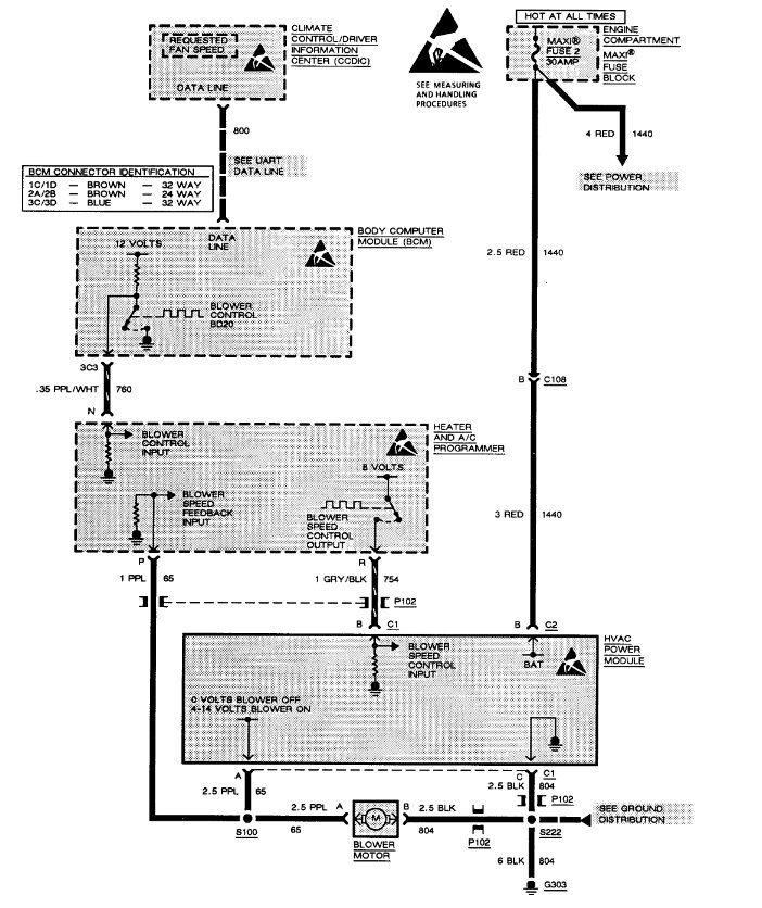

Nothing when i activate blower speed. jumped blower motor direct with battery power and it works. what do i look for fuses are good?
Aug 24, 2023 at 5:10 AM
  • 55,402 POSTS
It sounds like you have a blown fuse, bad speed resistor or the ground is bad. here is a guide to help you check for power and the blower motor wiring diagrams so you can see how the system works and which fuses and grounds to check:
This guide can help as well:
https://www.2carpros.com/articles/blower-fan-motor-works-on-high-speed-only
Check out the images (below). Please let us know what you find.

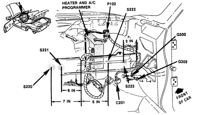

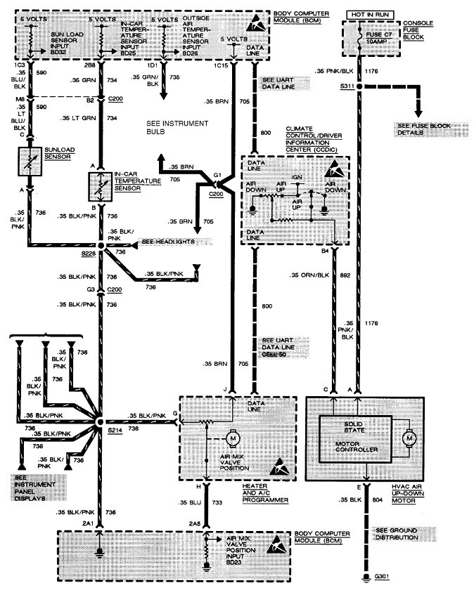

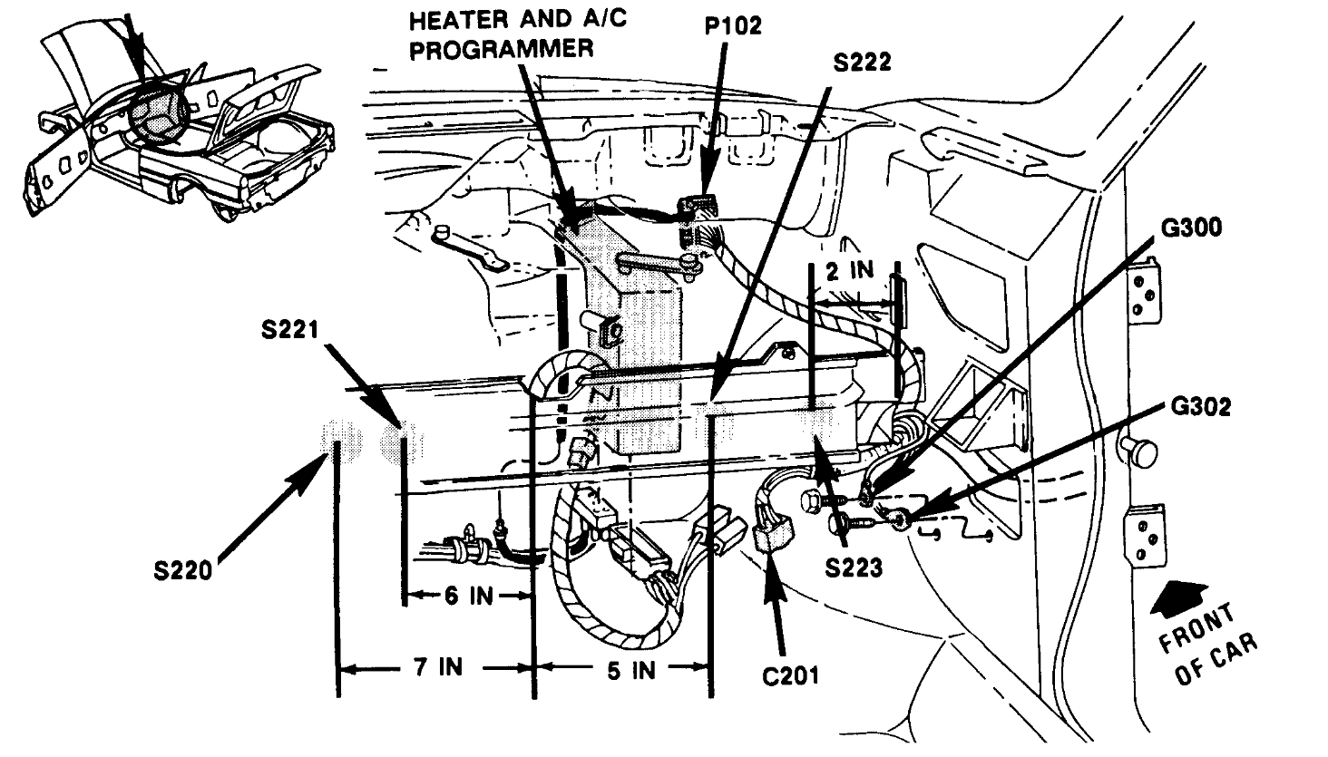

HVAC blower motor not working. I replaced the blower module it is still not working jumped blower motor 12v works fine. Need location of module relay. If relay turns out to be good could it be the programmer?
Sep 1, 2023 at 5:12 AM (Merged)
  • 55,402 POSTS
I have seen the programmers go out and cause this problem, here are the location of the components needed to help us fix the problem. I found a better wiring diagram as well, Check out the images (below). Please let us know how it goes.
Sep 1, 2023 at 5:15 AM
JIMMY CHRISTOPHER
I didn’t see relay location ?
Sep 1, 2023 at 5:31 AM
  • 55,402 POSTS
Looking at the wiring diagrams I don't see a relay for the system?
