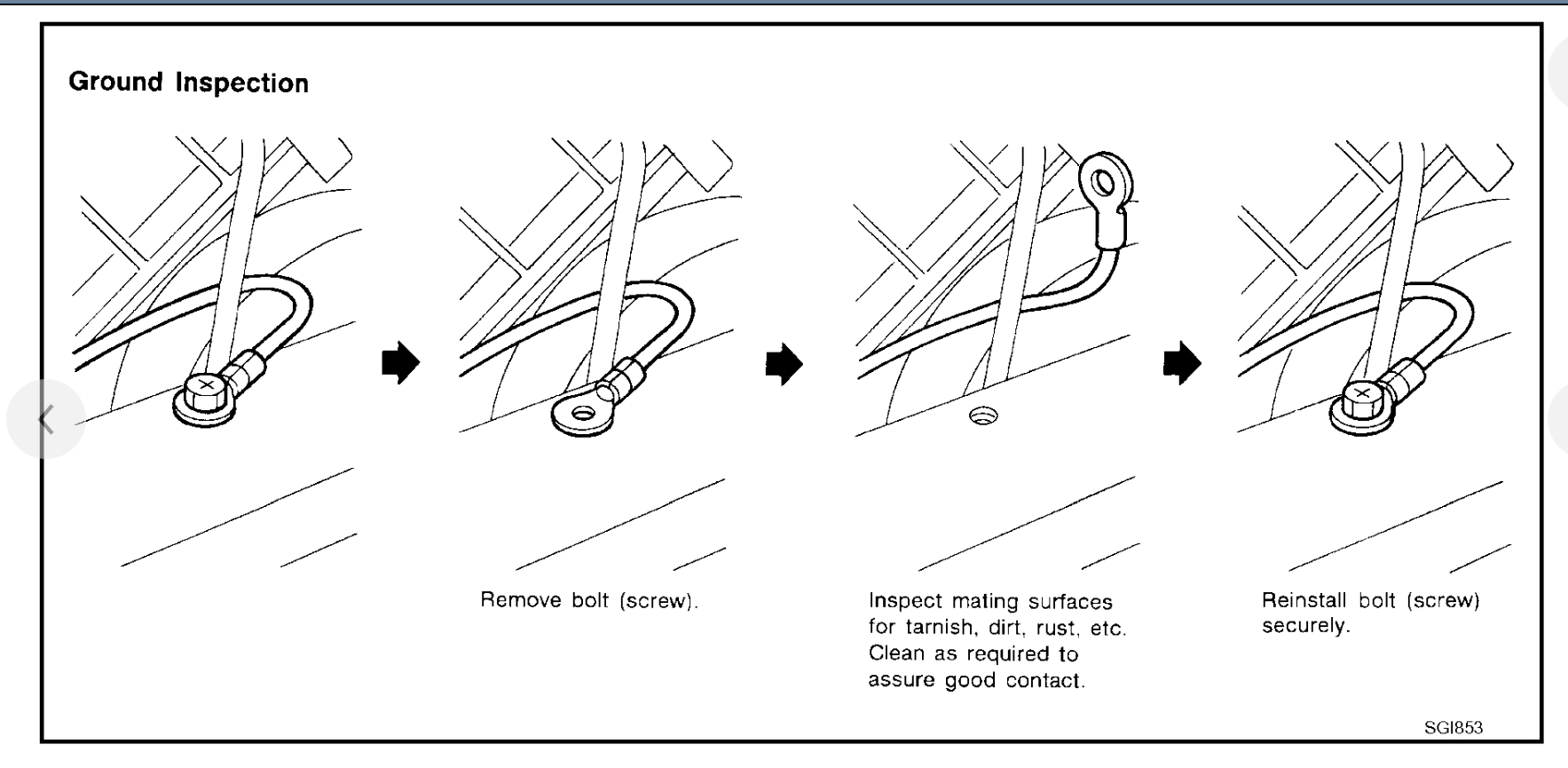

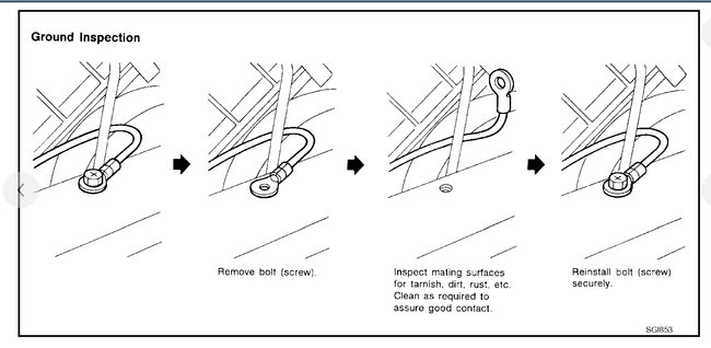

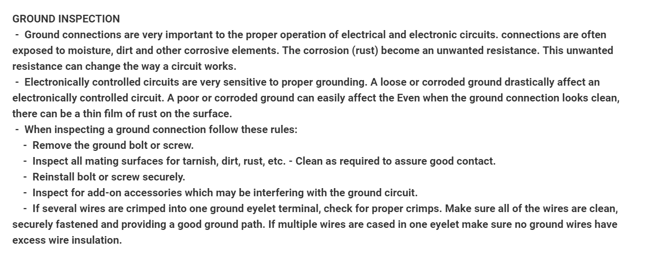

It sounds to me like this could be a problem with Ground#207 near dash harness and near the blower motor. Make sure that the ground is clean, corrosion free, tight, and making good metal to metal contact. In the diagrams down below I have included a guide for how to inspect ground connections. Please go through it and get back to us with what you are able to find out.

Thanks so much for getting right back with me. I am about to start looking for ground issues as you recommended. Surely sounds reasonable to look! How do I know where to find Ground # 207 near dash harness? Is it under hood on firewall, or inside under dash. Is there a user friendly wiring diagram that I can reference?

I am sorry. It is not Ground #207 it is Ground #206 which is located behind the dash panel on the right center support. I can't find a picture or a diagram showing it anywhere. It shouldn't be hard to find though, it's a black/orange wire with a ring connector on it with a bolt holding it in place. Please get back to us with what you are able to find out.
