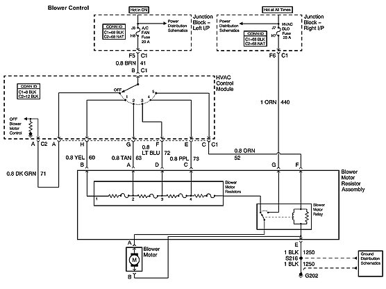

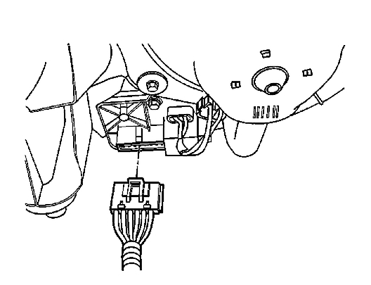

The blower suddenly stopped working. Checked; no power at motor, fuse in drivers side dash has power and fuses are good, when I move fan speed control to hi I can hear the relay activate, but no blower. A schematic of the wiring would help. I do not know where the relay is? Thank you.

The relay is incorporated into the blower motor resister which is mounted into the blower housing.

Replaced resistor (what a chore) original and found 25a fuse bad too. Thank you much and where do I donate?
