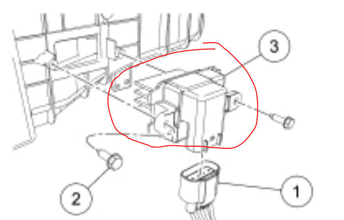

My AC stops working. Compressor does not engage; I replace the module on blower motor. It works for a while, but it stops and I have to replace it again.

Are you referring to the blower motor resistor? I that part keeps failing, make sure the electrical connections are in good condition and not arcing.
If they are good, there is a good chance the blower motor itself is drawing too much amperage and causing the resistor to fail.
Take a look at the pic below and let me know if that is what was replaced. They refer to it as the blower motor speed control unit.
See pic below.

That helps a lot, Thanks.
