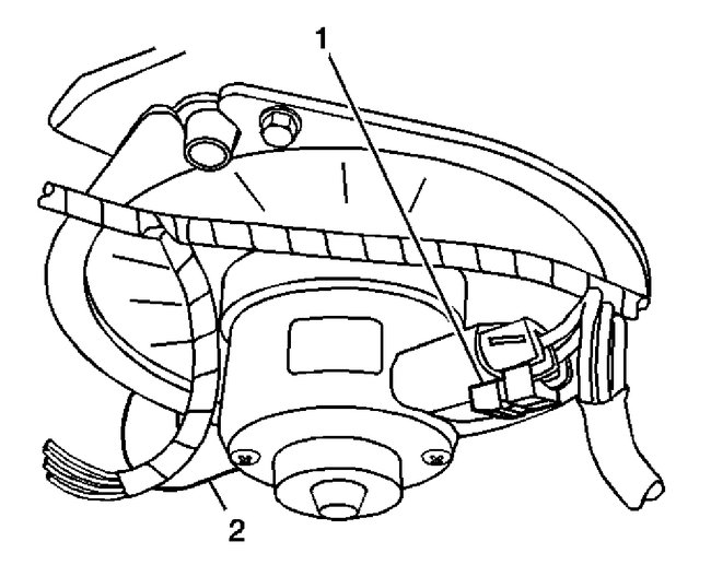

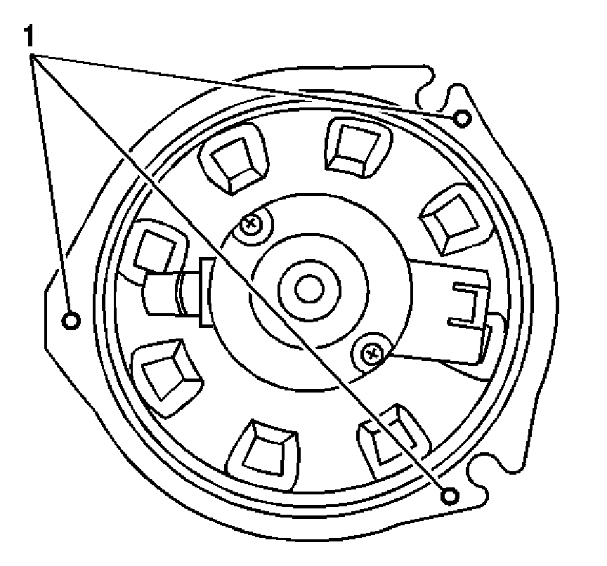

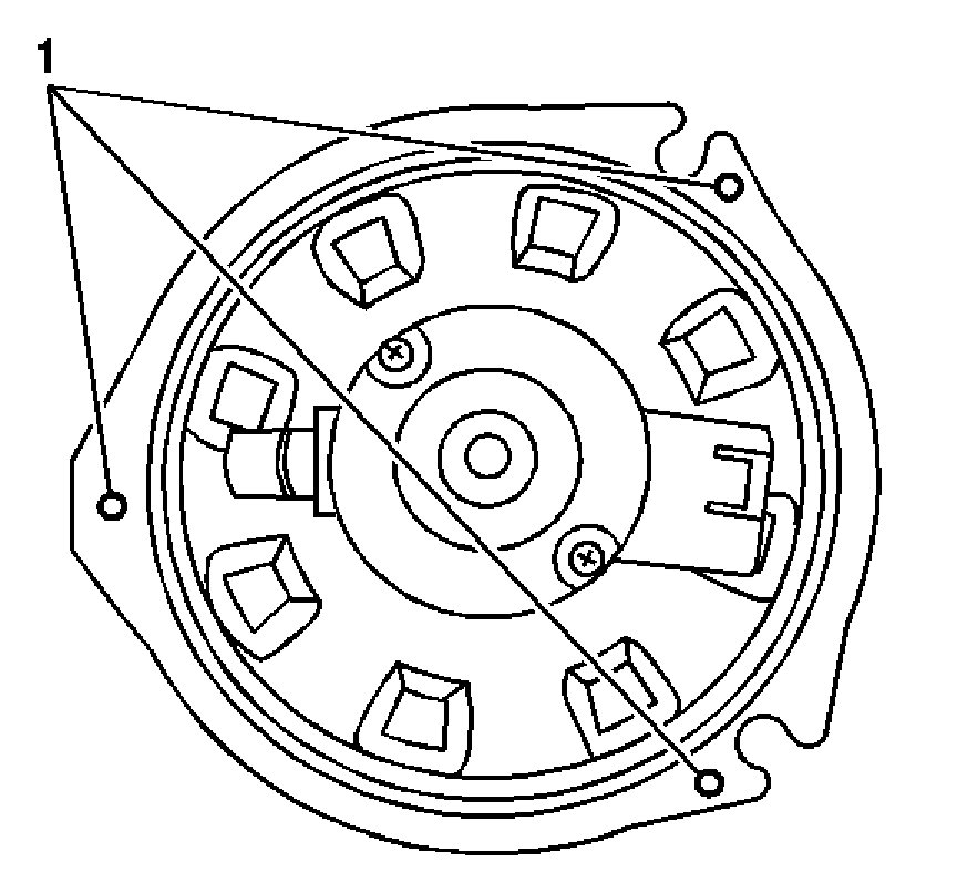

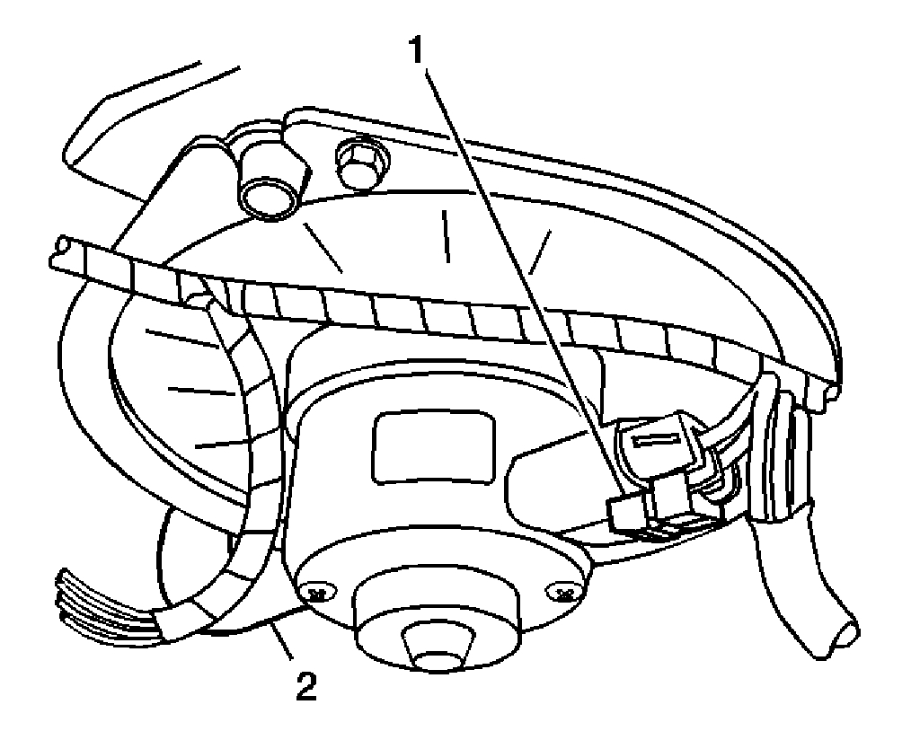

I need to know where the location of the blower motor on the car listed above custom model.
Jun 24, 2020 at 9:30 PM
  • CAR REPAIR CONTRIBUTOR
  • 110,190 POSTS
It's under the dash on the right side below the glove box. Here are the directions for removal and replacement. I'm adding them in case you need them. The attached pics correlate with the directions. Here is a guide to help you step by step with instructions in the diagrams below to show you how on your car.
https://www.2carpros.com/articles/blower-fan-motor-works-on-high-speed-only
BLOWER MOTOR REPLACEMENT
REMOVAL PROCEDURE
1. Remove the right side sound insulator.
2. Disconnect the electrical connector (1) from the blower motor.
3. Disconnect the blower ventilation tube (2) from the module.
4. Remove the blower motor screws (1).
5. Remove the blower motor from the housing.
INSTALLATION PROCEDURE
1. Install the blower motor into the housing.
NOTE: Refer to Fastener Notice in Service Precautions.
2. Install the blower motor screws (1).
Tighten
Tighten the screws to 1.7 N.m (15 lb in).
3. Install the blower ventilation tube (2) to the module.
4. Connect the blower motor electrical connector (1).
5. Install the right side sound insulator.
