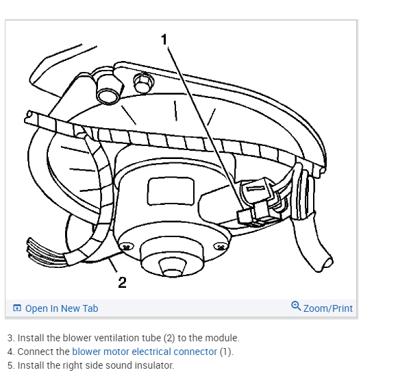

Blower motor just stopped working the other day after we went over a bump
2004 BUICK LESABRE
255,000 MILES • 3.8L • V6 • 2WD • AUTOMATIC
CHEGINGER

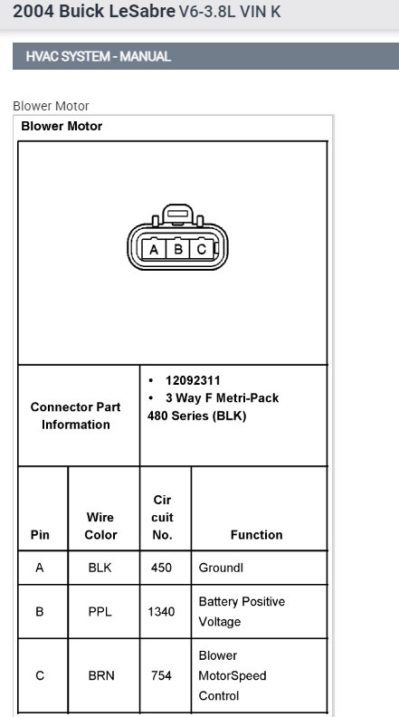

The AC/heater blower motor was working the other morning on our way home we went over a set of railroad tracks and it just stopped working. within the last week or so it's been kicking off kicking on every time we hit a bump and then all of a sudden now it doesn't work. I'm afraid that I might have to change the blower motor is there any other options that aren't too expensive that it could be?
Oct 24, 2021 at 9:02 PM
SQM
  • 6,383 POSTS
It is possible to have loose wire to the blower motor.
It will be a good idea to check the blower motor harness and make sure it is secured and does not have any corrosion or loose wire(s).
https://www.2carpros.com/articles/blower-fan-motor-works-on-high-speed-only
