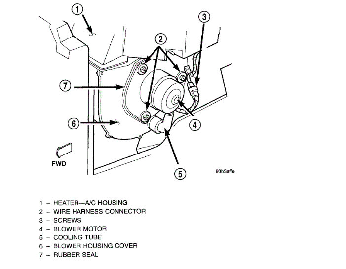

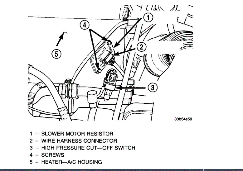

The blower motor in my van just went out. a few months ago it was giving me troubles, I found the resistor harness was burnt up. I changed the plug, and the resistor and it worked fine for a few days, then I lost all speeds but high. then today it just stopped working all together. the plug has a good connection, and I replaced the resistor just to be safe, it didn't help. so I changed the motor, it started working for a few seconds on all speeds then quit again. the relay is grounding out like it should but I'm not getting power to the motor, or anything at the resistor.

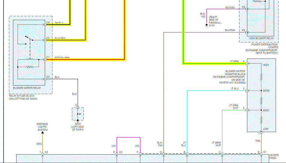

I attached the wiring diagram for you of the blower motor system.
Do you have a test light or voltmeter to do some checks?
The resistor and harness burned up the first time from the blower motor drawing too much current. You should have replaced the blower and resistor at the same time.
Check the fuses for power on both sides with the key on.

Okay, check the 2 fuses for power on both sides in the first diagram I sent you.

Okay, go to the relay. Check for power on the red/dark green and the black/orange wire with the key on.

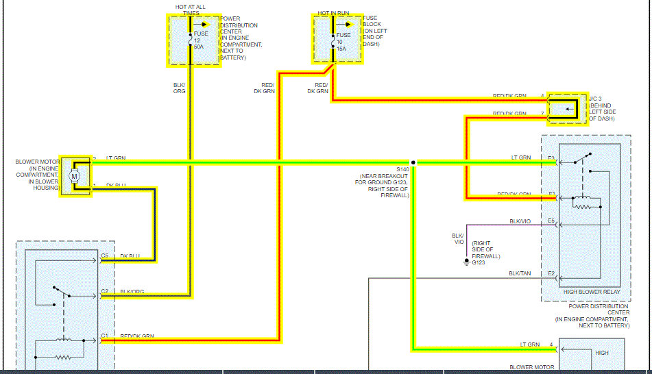

I have power to 86, the other 3 are ground.

86 is positive, 85 is ground, 87 is ground that connects to 30 ground. I have continuity from 87 to 30 when relay is on.
Jul 16, 2020 at 9:43 AM
Okay, 86 is good. 30 should have power as that is the load side of the relay.
30 is fed by the 50 amp fuse in the fuse box. If the fuse is and you have power on both sides, then you have a harness issue between the fuse box and pin 30 on the relay.

I have ground to motor through relay but no positive at any of the resistor wires.

Never mind, I was checking the wrong relay, the one in the dash is bad.

I flicked the relay, it clicked on, then the blower came on.
