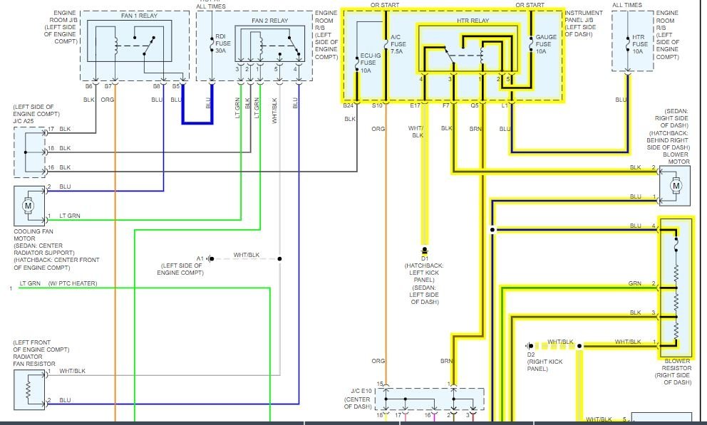

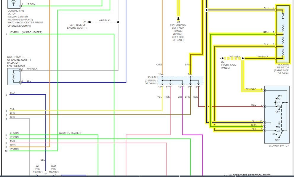

I checked blower connecting to battery and fan is working. I also checked current continuity on resistor and okay. I also checked current continuity from cable connecting to resistor but no current. The speed dial activates radiator fan and A/C.
Jul 17, 2020 at 4:34 PM
Good morning,
I attached a wiring diagram for you to view.
https://www.2carpros.com/articles/how-to-check-and-replace-a-electric-power-window-motor
Do you have a voltmeter or test light for testing?
You need to start by checking the fuses.
