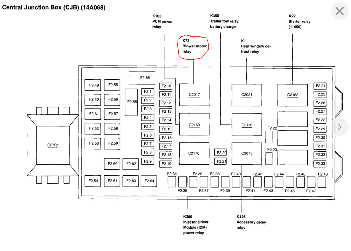

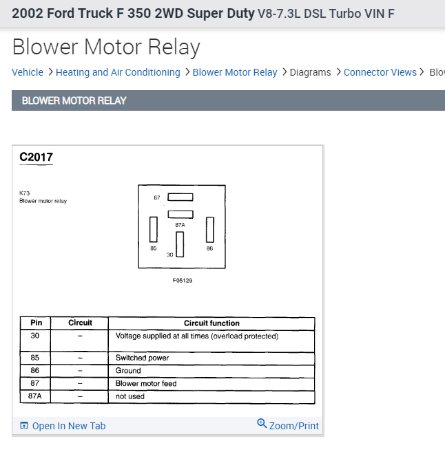

A/C blower fan just stopped. Identify blower fuse and location. This truck doesn’t have an under the hood fuse box. Why not?
Dec 17, 2021 at 9:02 AM
SQM
  • 6,383 POSTS

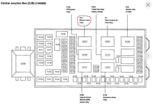

There is a relay for the blower motor. It is located under the hood in the fuse box.
You mentioned your truck does not have a fuse box under the hood?
Can you upload a picture of the under-hood?
Check for any corroded or bunt pin(s).

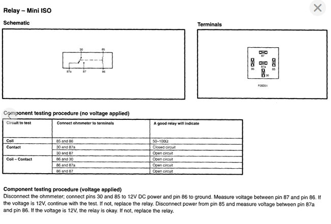

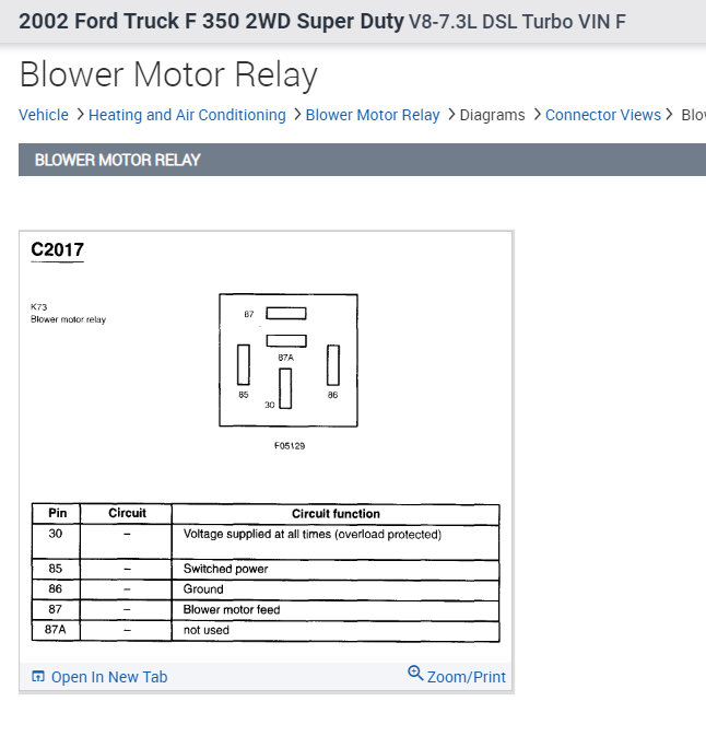

That relay can also be tested:
See diagram below for the location.

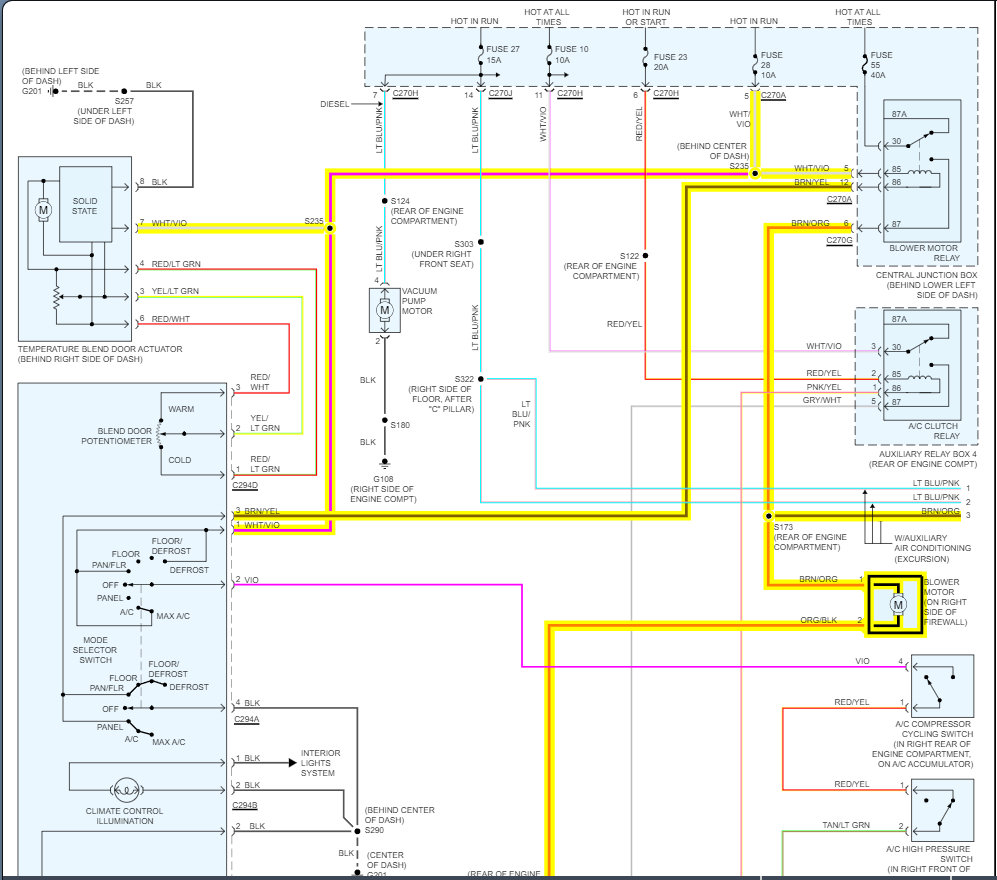

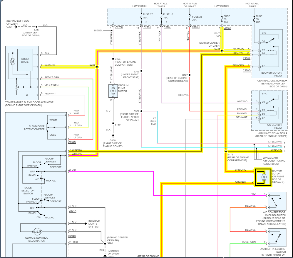

Good morning,

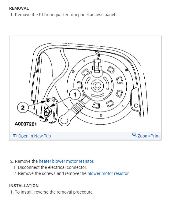

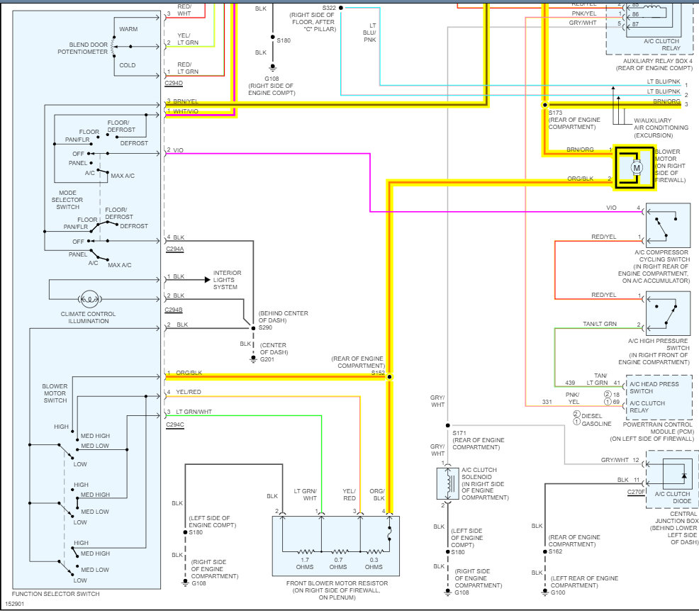

I attached a wiring diagram for you to view. The first thing I would do is check for power to the blower motor. Check both sides for power as the ground runs through the blower resistor.
https://www.2carpros.com/articles/blower-fan-motor-works-on-high-speed-only
