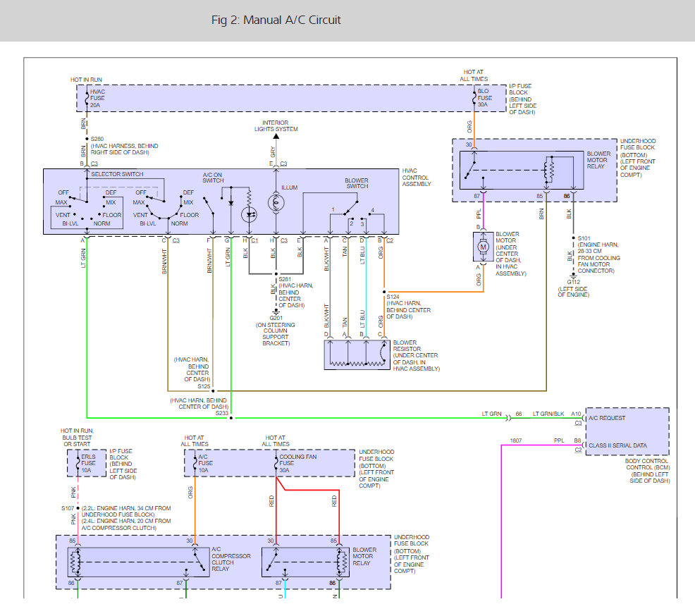

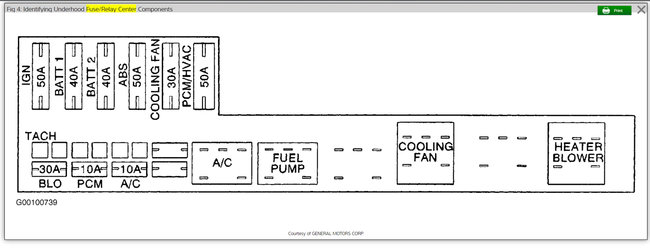

I have changed the regulator at the blower motor and the one under the hood. still does not work. what else is there? Thought maybe the switch.
Oct 2, 2017 at 11:48 AM
  • 55,649 POSTS
It sounds like the blower motor or relay is not working.
Here are some guides and diagrams (below) to help us get the problem fixed:
https://www.2carpros.com/articles/blower-fan-motor-works-on-high-speed-only

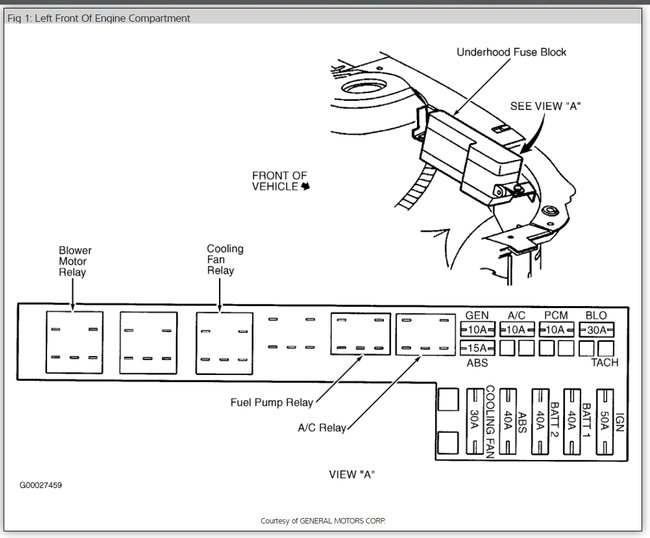

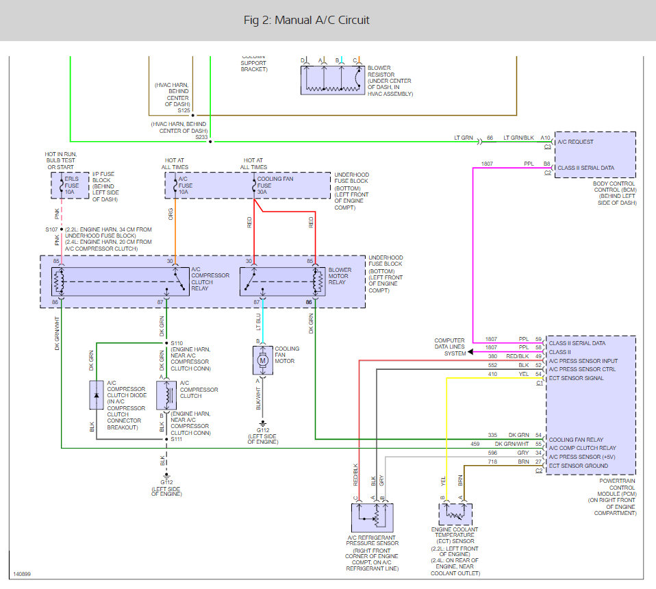

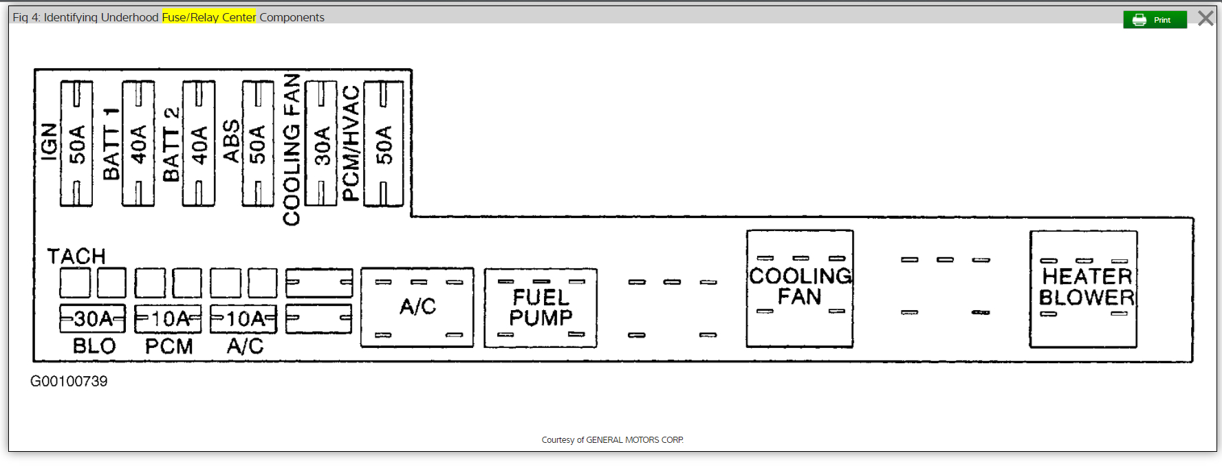

In the under-hood fuse box check cooling fan fuse. if good need test light check for voltage on light blue wire at fan with A/C on voltage?
Thanks for the donation.
Oct 3, 2017 at 2:22 PM (Merged)
KEVIN55NAPA
checked cooling fan fuse, it is good. Test only light blue wire coming off fan i could find and no glow from test light.

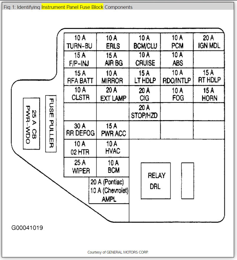

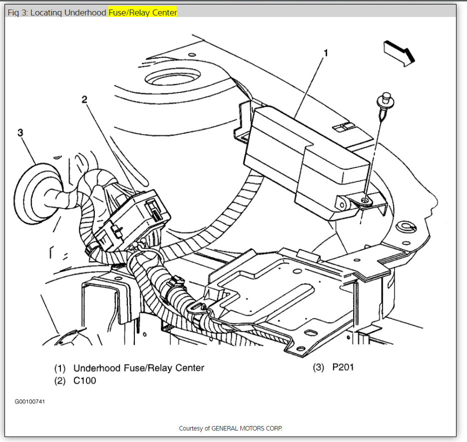

First check the fuse panel between the door and dash. Also under the hood, there is a relay and a 30 amp fuse and another fuse for the blower in there as well in the fuse panel beside the battery.

Check fuses, but I would suspect the switch on the dash as the problem. You can remove blower motor connector and apply twelve volts to motor to see if motor is problem, but I would suspect switch.

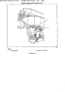

ALEXN
I have that problem once in two years. Blower resistor. First time I spent about an hour to replace it. Then only five minutes after I modified farther screw socket. Good luck. See attached picture:
https://images.2carpros.com/forum/automotive_pictures/296481_Blower_1.jpg

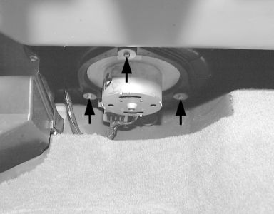

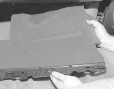

My blower motor does not work. How do I remove the motor? Is this a serious or fairly simple instalation?
Oct 4, 2017 at 5:44 AM (Merged)
BLUELIGHTNIN6
  • 16,542 POSTS
The blower motor and fan are serviced as an assembly only. Listed below are the removal/installation procedures for your vehicle. If you feel you are not experienced enough to do the job yourself, I suggest having a shop do it to prevent any damage to vehicle or injuries to self. Rrmoval: Disconnect the negative battery cable. Remove the passenger side sound insulator. Detach the electrical connections from the blower motor. Remove the blower motor retaining screws, then remove blower motor and fan assembly. Remove the sound insulator from underneath the passenger side of the instrument panel
https://images.2carpros.com/forum/automotive_pictures/261618_0900c152800a7227_2.jpg
Remove the retaining bolts for the blower motor assembly
https://images.2carpros.com/forum/automotive_pictures/261618_0900c152800a7227_3.jpg
Installation: Install blower motor and fan assembly, then secure using the retaining screws. If equipped, connect the blower motor cooling tube. Attach the electrical connections to the blower motor. Install the right side sound insulator. Connect the negative battery cable. Hope this helped. Thanks for using 2carpros.com!

You need what we call a blower motor resistor.
It is located beside the blower motor and it has about five wires .
