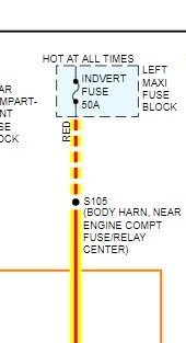

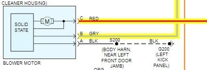

So this should be the correct model, you should have battery power on the red wire, the grey wire is the control wire going to the heater and A/C programmer. Start by checking this 50amp fuse labeled INDVERT. It should be in the engine compartment fuse box. Its a big maxi fuse. Make sure its not burnt and check that red wire at the blower for power.
The black wire at the blower is the ground wire, you can check this by hooking a test light to battery positive and touch the black wire, if the ground is good the light will light up. Or you can use a multi-meter and do the same thing, battery positive and touch the black wire, you should read battery power.

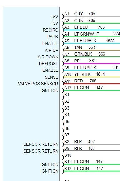

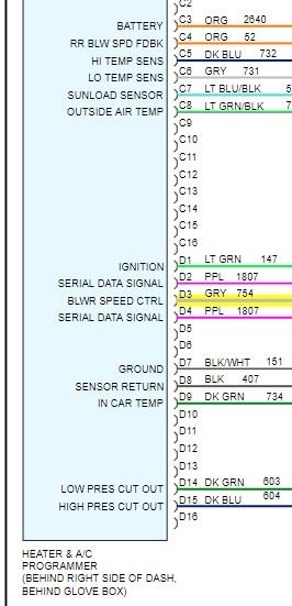

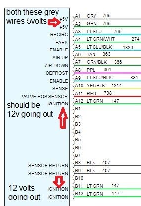

Go by the wiring colors to make sure it's the right module, like this, the first 2 are grey, next light blue, then light green/white, etc. those 2 first grey wires should be 5 volts, that's the reference circuit. We have to make sure the module has all the proper powers and grounds, that's why this is so important.
Jul 28, 2020 at 6:05 AM

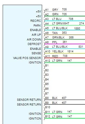

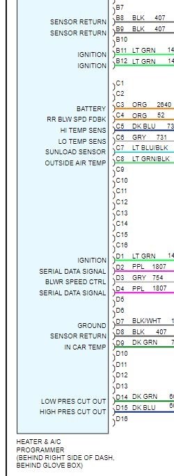

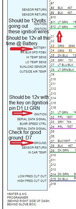

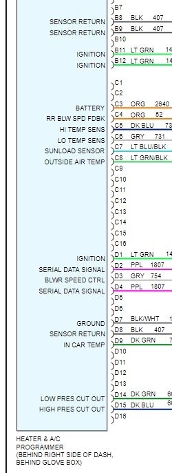

AL514
  • 5,668 POSTS
Here's everything you need to check at the Programmer Module, in the 1st picture, all the time battery power coming in on C3 orange wire, ignition power going out 3 light green wires, and a ground black/white wire. Same as 2nd picture, its all labeled for you. The 2 wires at the top ones grey the others green are very important that they both have 5 volts with the key on or running.

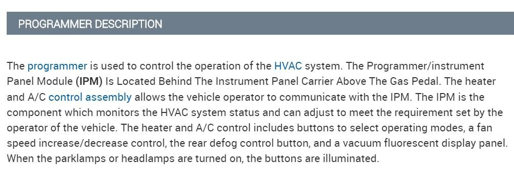

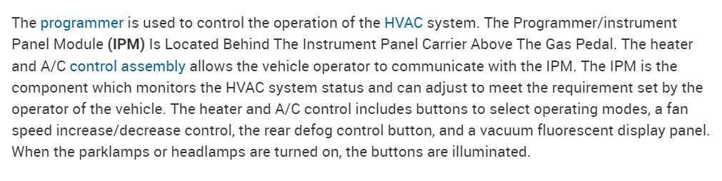

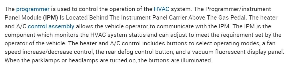

AL514
  • 5,668 POSTS

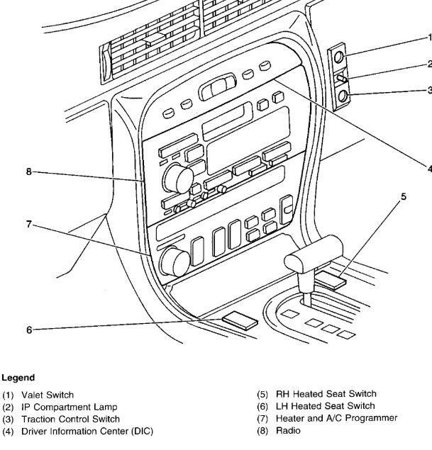

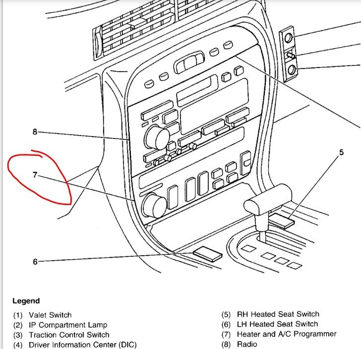

According to this it actually seems to be above the gas pedal, behind the head unit. I'm not sure why they're giving different locations for this thing.

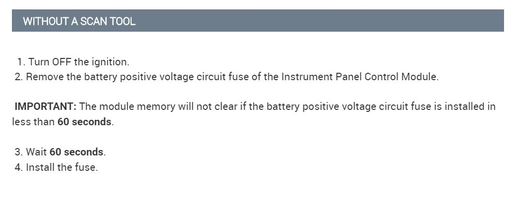

Here's the relearn procedure if you determine you need to replace the Heater and A/C programmer. Let me know what you find out tomorrow.

AL514
  • 5,668 POSTS

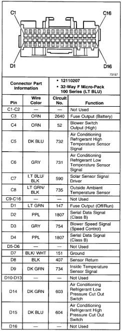

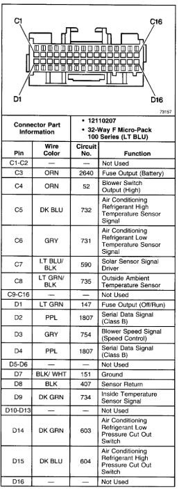

Does this car have a screen where you can select different options? I'm reading here that it might have its own on board diagnostics. This is the plug you should see on the back of the heater and A/C programmer. The D3 pin is the grey wire for the blower motor control. There is another grey wire there too so make sure its the right one. And check C3 orange wire for Battery +, and D1 Lt Green Battery + with key on. The heater and A/C programmer is right under the radio.
Jul 29, 2020 at 8:01 AM
DEWEY SMITH
  • 10 POSTS
The C3 and D1 checked out don't believe i had anything on the gray wire. I'll let you know tomorrow as I'm done for today. going to pick up another A/C controller tomorrow from an El Dorado same year and model as mine see if it will cure the ill. I'll get back to you and let you know either way. thanks again.
