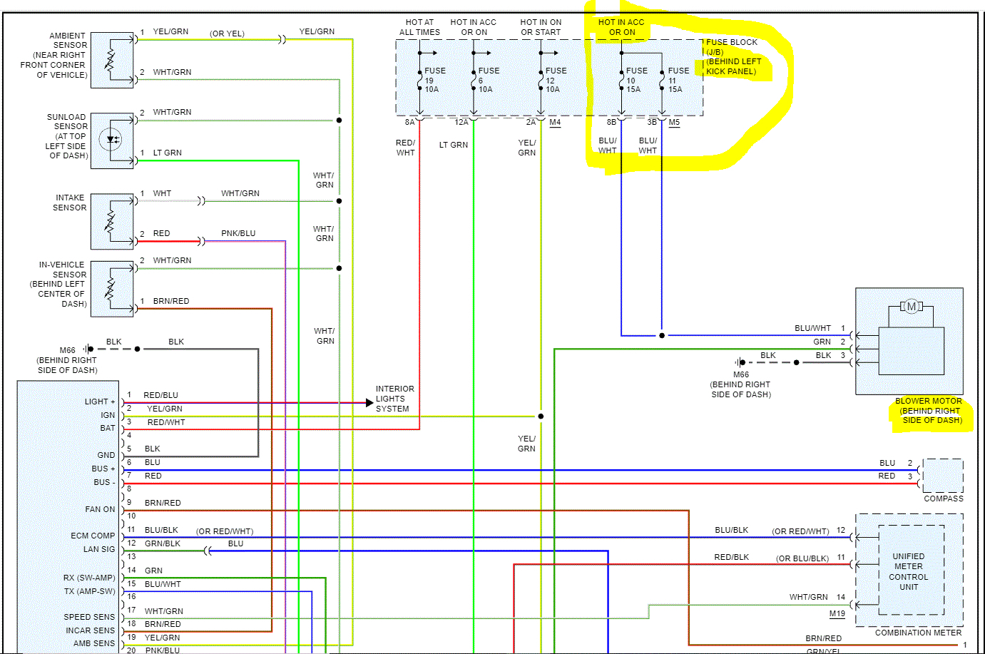

This vehicle was parked over an extended period, but before parking it, the AC was working fine. Now the vehicle owner wants to start using the vehicle back, when he turns on AC and notice that blower was not working and he drove to my workshop and I used factory diagram to trace power and signal from A/C amplifier and also ground, it passed test, I diagnosed the A/C system, and it didn't report fault code. At this point I suspect that the A/C system is automatic not manual A/C that the blower turns on with ignition on, but automatic A/C hence there's no refrigerant in the system to pressurize and send signal to A/C Pressure sensor to turn the blower on, the blower will not work. Or is there anything else?

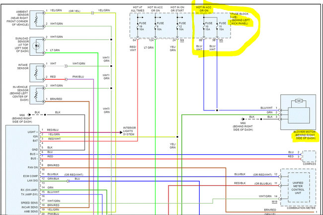

The blower motor will work if the A/C refrigerant is low or empty. The blower motor on this gets power from two fuses in the fuse box in the vehicle behind the left kick panel. See pic 1 below.
For the motor to operate, a ground path has to be provided by the AC amplifier.
Check fuses first. Make sure they are good and have power to and from them. If they are good. Note that they will only have power with the key on or in acc. If they are good, go to the blower motor and check the blue wire with a white tracer for power.
Let me know what you find.
See pic below,

Note that they will only have power with the key on or in acc. If they are good, go to the blower motor and check the blue wire with a white tracer for power. I have traced the fuses and they are okay, then I go to the blower motor and check the blue wire with white trace while I turn the ignition to Acc and on position, but it didn't operate, I measure voltage on the blue wire it gives 12volts, I checked the resistance to ground and it was okay. Now I measure voltage on green wire from a.c. amplifier and it reads 04.57volts, I said that it is not the a.c. amplifier...it is supply power to the blower

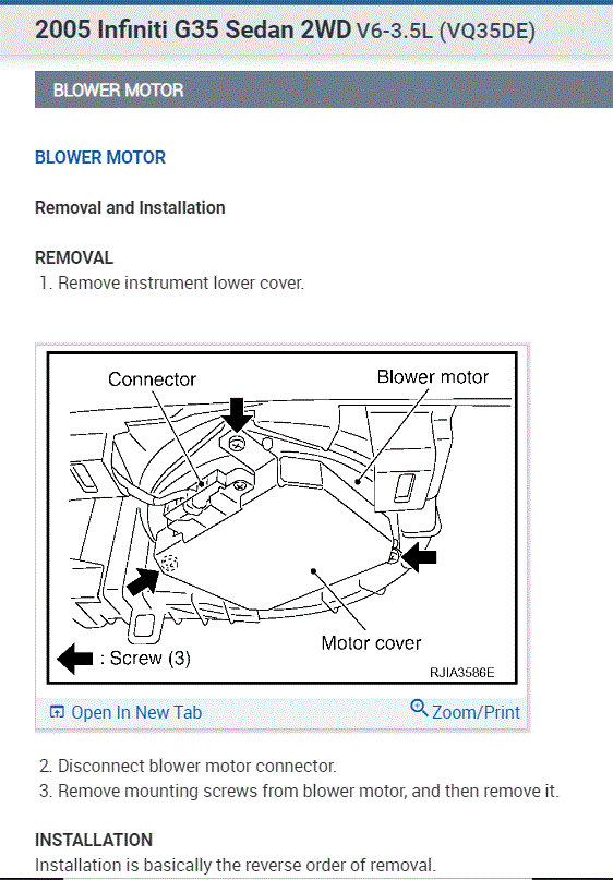

If you have power to the blower motor and you have ground, it sounds like the motor itself has failed.
The 4.57 volts from the amplifier is lower than the battery voltage based on how fast the fan should be turning. I feel the motor needs to be replaced.
I attached the directions below. This isn't a bad one to do.
See pic below.
