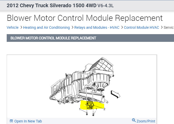

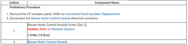

Then we don't have a short to a different circuit. I suspect either the connector at the blower motor control module is damaged or the module itself is bad.
If you look below, I attached the directions for the removal and replacement of the module. What to do is first disconnect it and inspect the connector. If it appears okay, then suspect the module.

I have ordered a new module, I will let you know the outcome after I get it. Everything started going wacky after I replaced it. I have checked the connectors several times. So. I may have just got a bad module. Thank you. I will keep you apprised.

Okay, module replaced and everything works. Thank you for all your help. I was about to pull the last of what little hair I have left out.
