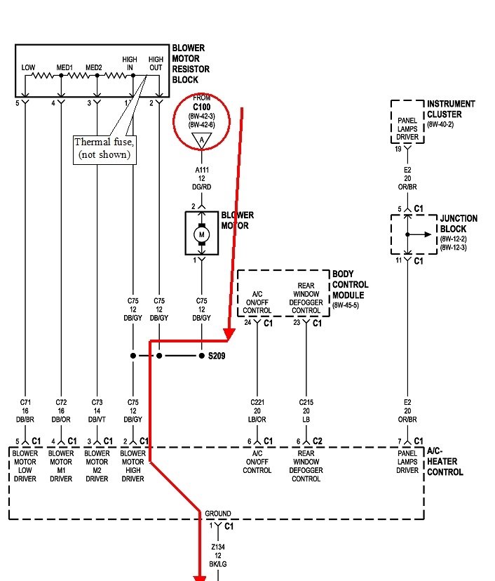

The first observation has to do with the fan speed switch. On the highest speed setting, the resistor assembly is bypassed and not in the picture. That's why it still works on that speed.
The motor has developed tight bearings. If you would like me to type a long reply of why this happens, I'll be happy to do so, but for the purposes of this story, it is sufficient to know that all electric motors draw very high current to get started, then, once they're up to speed, that current goes down a lot. (Old V-8 Ford and GM starter motors draw well over 300 amps to get the engine spinning, but once they get it up to cranking speed, that drops to around 200 amps).
With the tight bearings, current flow increases a lot. Eventually that burns open the thermal fuse that is built into all resistor assemblies. That's the part that fails. Until that happens, the bearings make the motor run too slow, and that results in higher current flow through it. The higher current flow creates stronger electromagnetic fields from the armature and stationary windings. Those stronger magnetic fields makes the motor stronger, so it gets back up to its proper speed. You see the normal speeds, but you don't see the greatly-increased current flow. That's what's taking out the thermal fuses.
Don't waste your time trying to lubricate the bearings. It's only going to end in disappointment. And definitely do not try to bypass the thermal fuse to save a few bucks. If it hasn't happened already, that high current is going to overheat the internal contacts in the fan speed switch, and / or the connector terminals at that switch. When either one of those overheats, the only way to prevent that from happening again is to replace the switch and the affected terminals at the same time. The heat generated by either the contacts or the terminals will migrate to the other and degrade them too. Replacing only the switch or only the terminals will lead to a repeat failure.

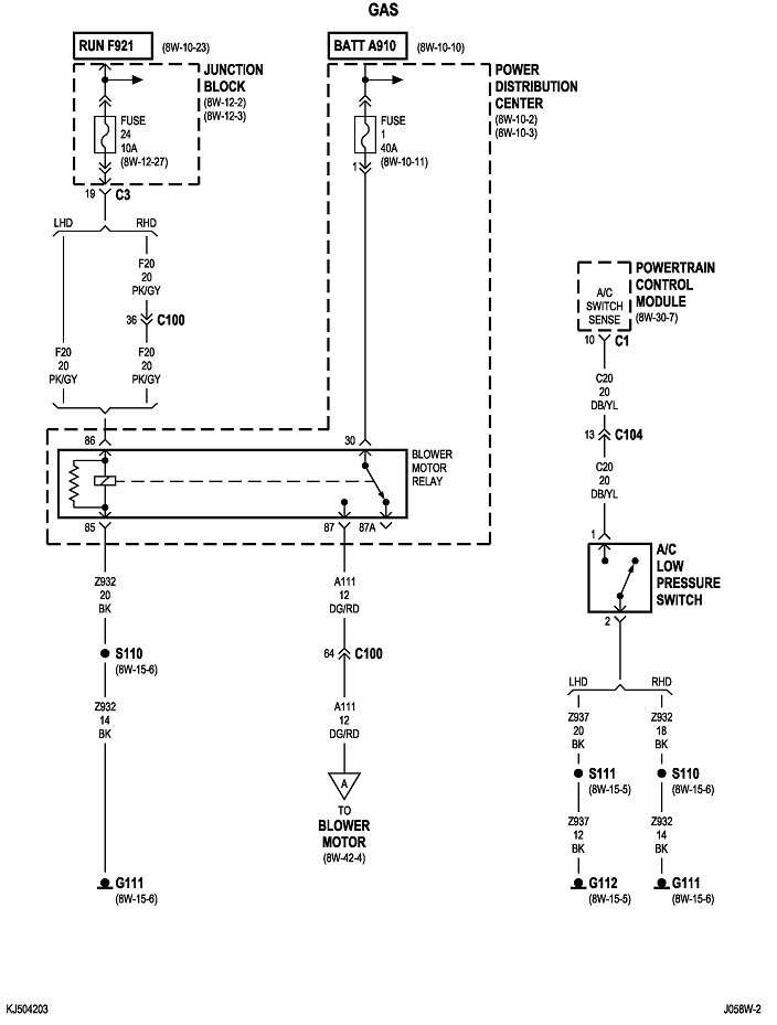

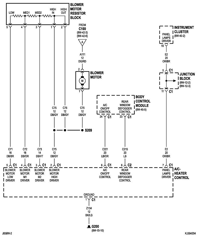

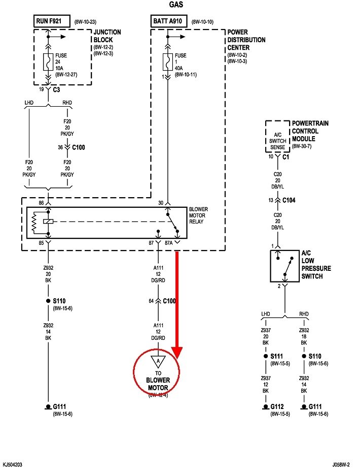

These first two diagrams are the parts that show the fan motor circuit. The last two are the same thing but I added the red lines to show current flow through the motor on the highest speed. You'll see the resistor on the top left is not in the circuit at this time.
