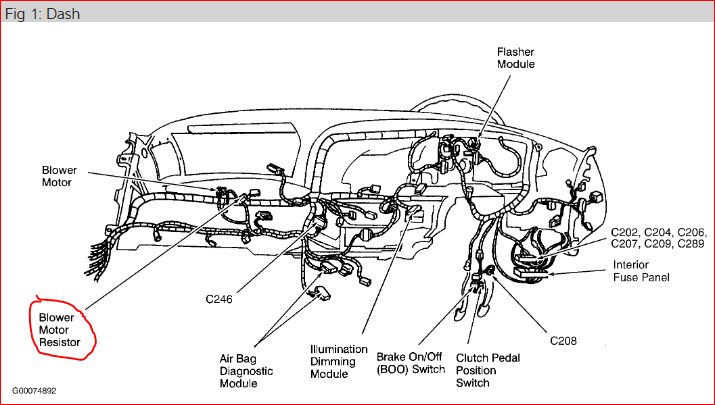

Blower motor blowing fuses. Replaced motor, still doing same. Runs on all speeds for approximately five to ten seconds then fuse blows.

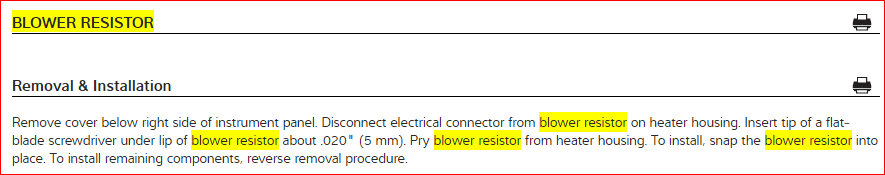

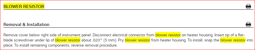

It sounds like you are having a problem with the blower motor resistor. Check to see if the harness/connector is melted/burnt/loose/damaged. Here is a tutorial showing blower motor replacement if it helps:
https://www.2carpros.com/articles/blower-fan-motor-works-on-high-speed-only
I've attached a few pictures below of its location.It's under right side of dash next to blower motor.Hope this helps and thanks for using 2CarPros.
