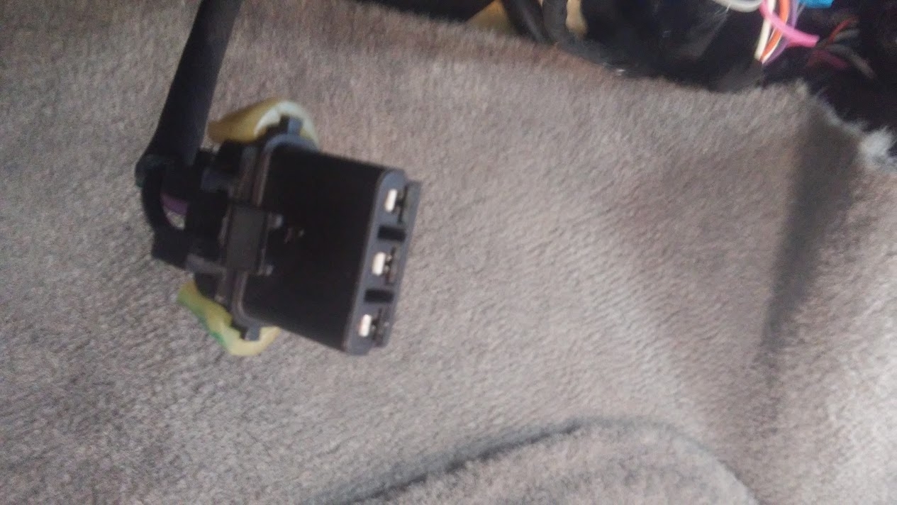

I have the base base model. The blower motor will not run properly unless I am pressing it in and holding it there. I thought it might have been the plug itself so I bought a new one, connected it, and got same result. I do not know what to do next. Would it possibly be the resistor? Also, what is the easiest way of getting to its location?

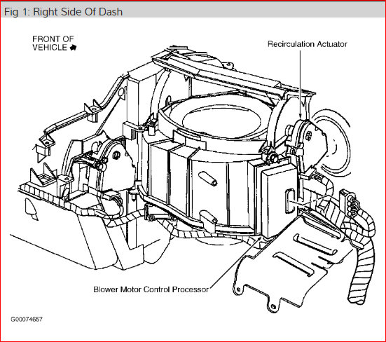

It is usually a little bit easier to replace the blower motor resistor by removing the actual glove box to gain easier access. I have attached a picture of its location. Be sure to look and see if any wires on the harness look burnt/melted that is usually what happens. Hope this helps and feel free to ask any questions if needed. Thanks for using 2CarPros.

Hi Lloyd, I see your post goes back to 2018, but I have the same issue. Holding the connector in and it works, even the varying speeds. So it doubt it's the controller. I purchase a new connector, but have the same issue. Did you find a solution?

This was a few years back, can I ask if the connector is in good shape, not melted or have loose connections? Can you upload an image of the part in question so I can see it?

Oh yes, the connector was in good shape and not melted or corroded.

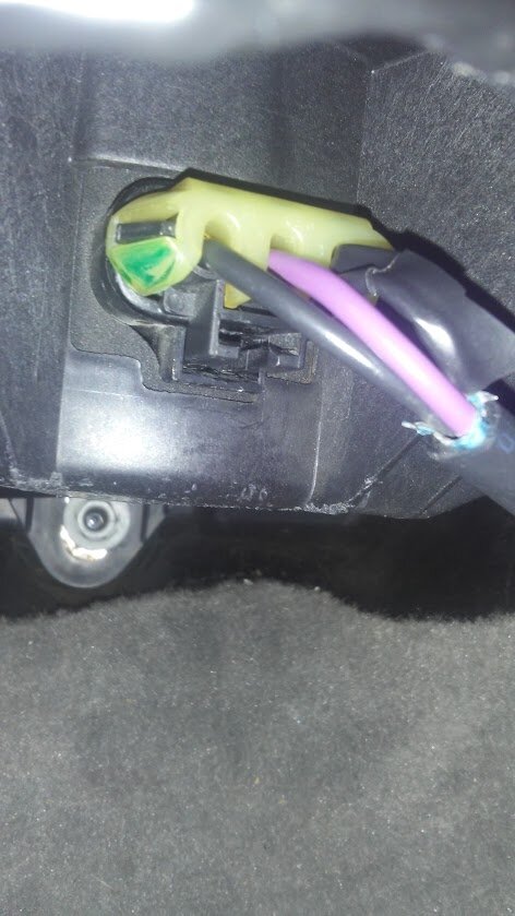

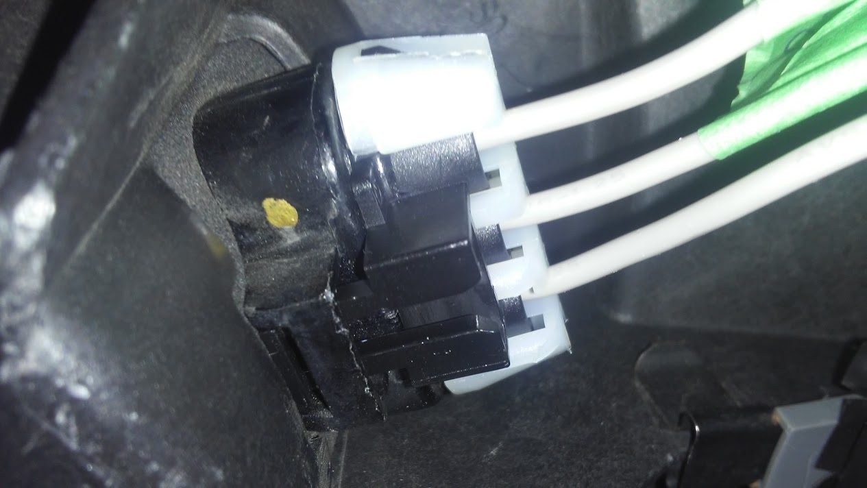

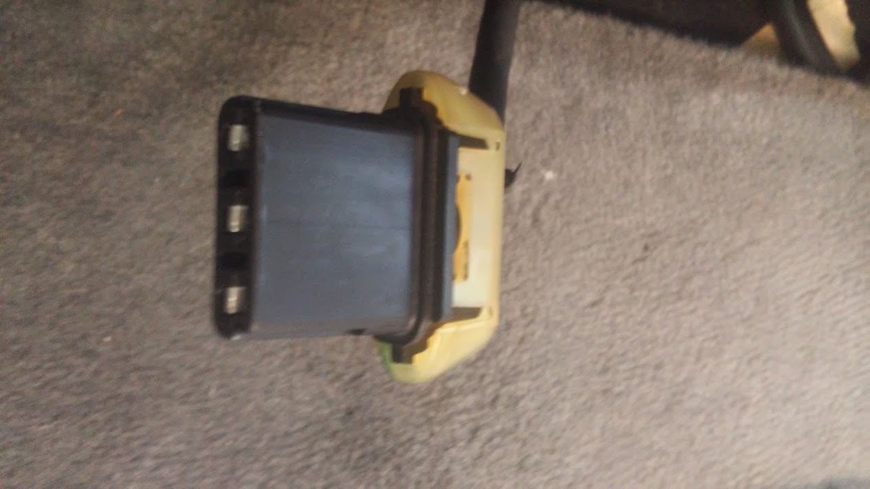

Two more images of the original connector and the new installed one.

Yep, that looks good, so you need to hold or move the connector to make the blower motor work? If so I would replace the resistor, it must have an internal break in the circuit board.
