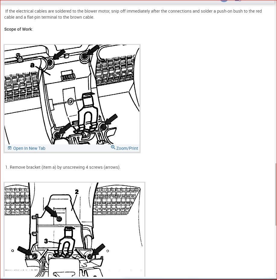

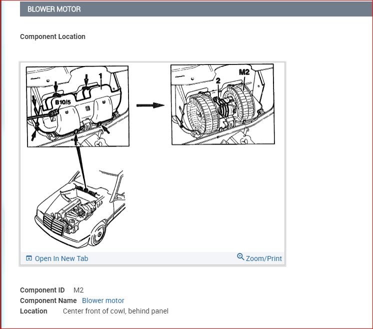

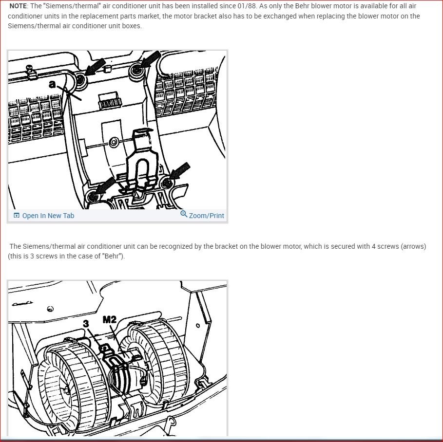

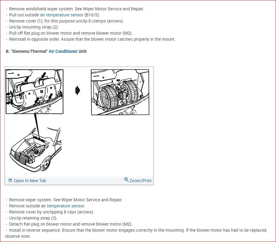

Need to know the location of the blower motor for the car listed above. The motor is needs to be replaced.
Jun 13, 2019 at 8:39 AM
Hi Kenniy,
I included the procedure on how to remove and install the blower motor in case you need that as well. Please let me know if you need anything else. Thanks
Jun 13, 2019 at 9:48 AM
KENNIY
Blower fan: thank you that helped out very much! The YouTube videos didn't show anything for that make or model of that car. and I couldn't find anything in the Chilton on Mercedes Benz. I really appreciate it I will be coming back to you guys for more questions. I do have a 1978 Chevy Bonanza 10 3 in the column straight 6 I'm having issues with adjusting the linkage. And finding the grommet for the linkage is next to Impossible. Could you make any suggestions on how to adjust? And where I could buy the grommets? And thank you very much again.
