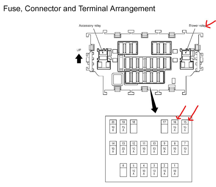

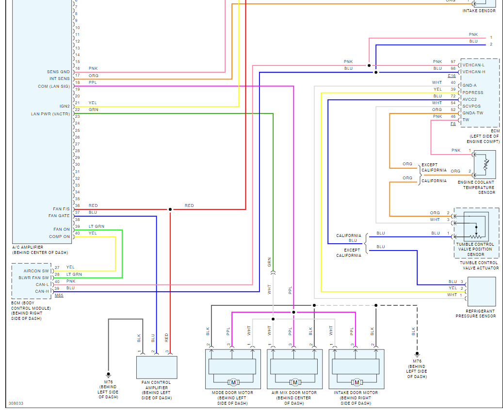

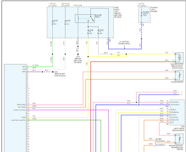

blower motor was very noisy then it quit working all together, no problem replaced blower motor and resistor it did not fix it. i have power to both fuses and blower resistor but nothing at the resistor are the motor i do not know where the grounds are and i have no wiring diagram. Can you please help me out?
Jul 15, 2024 at 6:10 PM
  • 55,423 POSTS
I would check for power at the fuse # 15 and # 16 in the fuse panel inside the truck left side. If there is no power swap out the lower motor control relay. Here is a guide to help and the blower motor wiring diagrams which show the ground locations as requested.
Here is the location of the relay and fuses as well. Check out the images (below). Let us know what you find.
