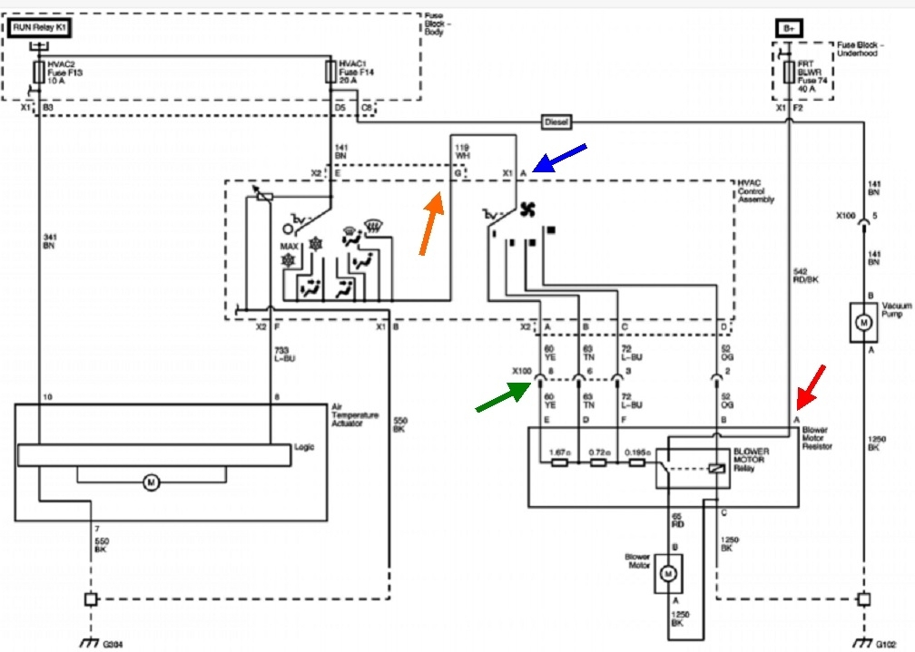

Blower will run on all speeds for anywhere from 5-20 minutes and then it will stop. Replaced blower motor resistor and it remains the same. Power to the resistor but not out from the resistor to the fan motor. Running direct current with a toggle switch temporarily. Next step is to examine the connection and connector to the fan switch in the dash. Would you agree with this and is there a way to test it. I'm hoping I see an overheated partially melted connector. If not, the switch I'm assuming it's a wiring issue. Could the new resistor be bad and can it be tested?

The problem with suspecting the resistor assembly is it is fed from two different 12-volt supplies. One is only for the highest speed and one is for all the others. If the fan stops working on all speeds at the same time, we have to look for what both circuits have in common.
I have a suspicion the 12 volts you found feeding the resistor is the red wire, (red arrow in my diagram). That circuit doesn't go anywhere until the highest speed is switched on, then current flows through the relay directly to the fan motor. That relay is turned on by the speed switch, just like it feeds the resistors for the lower speeds.
It's important to understand when taking voltages readings in this type of circuit, they are only valid when taken with everything plugged in and connected. There are times it is necessary to unplug things, but we need to know what to expect for voltage readings then. What can be helpful is to use an old-style test light with an incandescent bulb instead of a digital voltmeter. Test lights require current flow to give their indications. Voltmeters can falsely show a voltage in a circuit that is actually dead.
Since you already have gained access to the resistor, lets start there. Verify it's that red wire where you found 12 volts. If it is, that one can be disregarded. It's the three by the green arrow we're interested in. Switch the speed switch to any of the lower three speeds. As long as that three-wire connector, X100, is plugged in, you should find some voltage on all three wires. They're yellow, tan, and light blue wires. The voltage comes in on the wire that's switched on, and feeds through different parts of the resistor, then shows up on the other two wires. We don't care if the voltages are a little different, just whether they're there or not. If you do find voltage there, you should have it on one motor wire too. If it's there, the motor has to have a bad ground connection. That isn't likely because you said there is no voltage to the motor.
Given that observation, I'm guessing the voltage you did find was on that red wire. We need to have it on the white wire feeding the speed switch. Going back to the three wires by my green arrow, if you do not have voltage there when any of the three lower speeds are switched on, look for that white wire on the speed switch first. Leave it plugged in, then back-probe into the back of the terminal if possible, or right on the switch's terminal. If you have voltage there, suspect burned switch contacts. I'm betting by this time you're going to find a badly overheated connector terminal on one end of that white wire.
If you do find a burned terminal, the only proper repair is to replace the terminal, the wire, and the switch. Either an overheated switch or terminal will create heat that migrates into the other part, degrading the contact or strength of the terminal. The part not replaced will begin to generate heat and cause a repeat failure. The excessive heat will also migrate into the wire and cause it to become stiff. Solder won't adhere to that, and crimp-type terminals won't make a good connection. Usually about four inches of wire must be cut off, then a new section of the same gauge spliced in. For terminals, you might find what you need in a pick-your-own parts salvage yard, otherwise, I cut out any melted section of a connector body, plug it in that way, then I use a universal crimp-type terminal on the new piece of wire and plug that in separately. For the new piece of wire, solder the splice, then seal it with heat-shrink tubing. Don't use electrical tape as it will unravel into a gooey mess on a hot day. I also solder the crimped-on terminal for best connection.

I was using a test light, and it was the thick red wire that lit up. I assumed that it was battery feed to the resistor. There was no power to the orange wire to the motor and the ground tested good. I may be able to do more testing tomorrow, otherwise it would be this weekend. Checking the white wire and the connector at the switch is next.

With no voltage to the motor, we know that's no good and it's unlikely the ground is causing a second problem, but regardless, I assume you checked the motor's ground with an ohm meter. That's not the best choice here. It only shows the ground wire isn't totally broken or corroded off. All you need is one strand of wire still intact to get a 0-ohm reading, but that won't pass the amount of current the motor draws. What will show up is the result of those broken strands if you had 12 volts getting to the motor. With a poor ground circuit, you'd find some voltage on the black ground wire, which is not acceptable.
In looking at the diagram, 12 volts feeding the motor circuit will go away when the mode switch is in the "off" position. Remember that for a clue that you found the right wire for next time in case you need to diagnose this system again in the future. This circuit is actually fairly common for GM vehicles going as far back as the 1970s. Unfortunately, burned switch contacts and connector terminals are also pretty common on all models, not just GM products.
