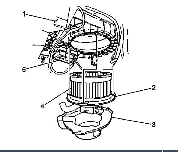

Blower for the heater and A/C does not work in any speed
176,000 MILES • 6 CYL • 4WD • AUTOMATIC
HLAIN86

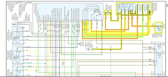

It worked off and on for a little while then quit altogether. I've replaced the blower resistor and checked all fuses and they all are good. I'm getting power into the blower resistor but none coming out of it. Of the resistor I can jump the wires and it will turn on. so I think it is a wiring issue somewhere but I'm not sure where to stay long as all the wires I can see look fine.
Jun 30, 2020 at 10:46 AM
Good morning,
Do you have a voltmeter or test light to dome checks on the system?
I attached a diagram for you to view and we will need to do pinpoint testing to determine the failure.
