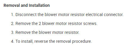

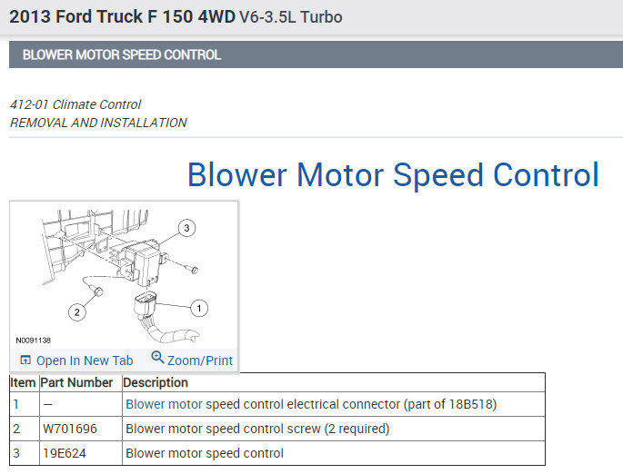

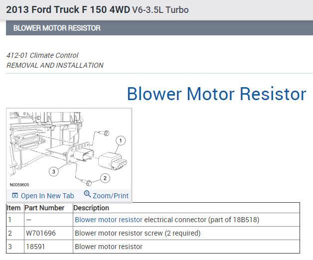

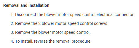

There are two things I would check for the blower motor condition you are experiencing. You should check both the blower motor resistor and blower motor speed control that are both mounted to the under dash hvac box. Here is a tutorial showing how to test for electrical wiring:
I would check the wiring harnesses for corrosion, being melted, or burnt. I've attached picture steps below on how to replace both the blower motor resistor and speed control including their location on your truck. Hope this helps and thanks for using 2CarPros.

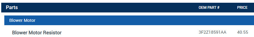

I can get more information about you truck if you can provide me with the last 8 digits of your VIN- vehicle identification number. Your truck does have a blower motor resistor and I've attached a picture of the Ford part number below. Let us know and we'll go from there. Hope this helps and thanks again for using 2CarPros.
