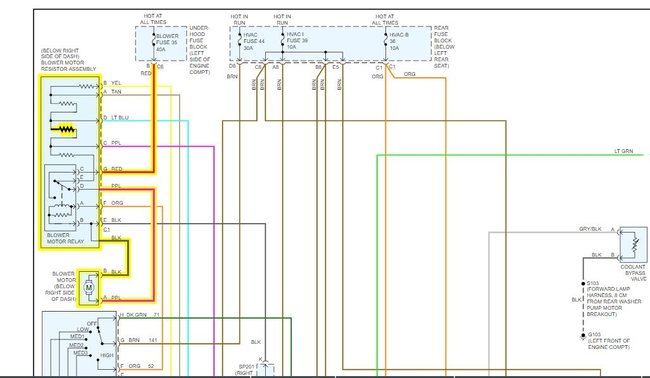

This is a shorted blower resistor. When it shorts internally, it will operate the blower at all times.

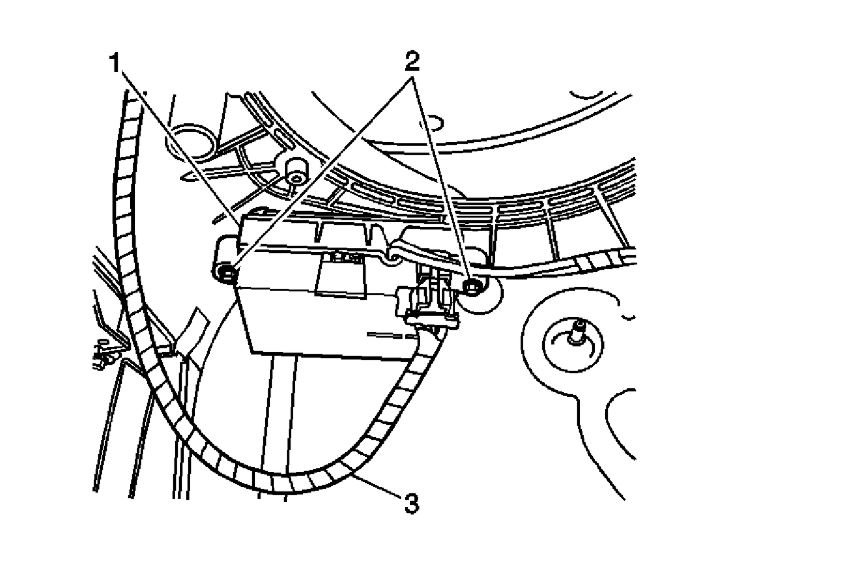

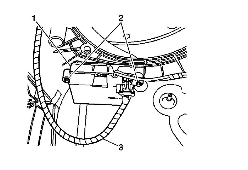

Picture and procedure below for you.
BLOWER MOTOR RESISTOR ASSEMBLY REPLACEMENT
REMOVAL PROCEDURE
1. Remove the right closeout/insulator panel.
2. Disconnect the blower motor resistor electrical connector (3).
3. Remove the blower motor resistor mounting screws (2).
4. Remove the blower motor resistor (1).
