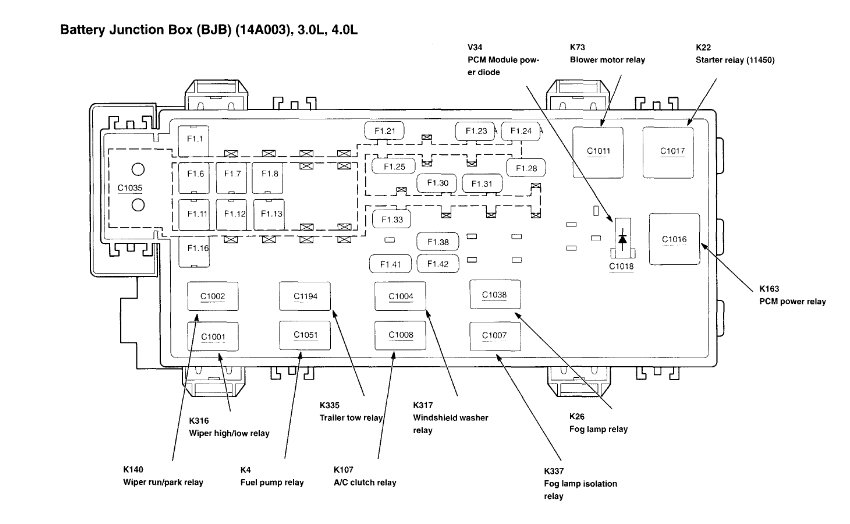

Where is relay for blower motor?
Dec 26, 2017 at 3:43 PM
Below the diagram for the relay location. Check out the diagrams (Below). Please let us know if you need anything else to get the problem fixed. Roy

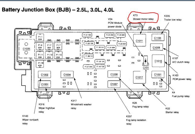

how can i tell if it's the blower motor or switch? i swapped fuses under hood. heater will heat up, just wont blow. was hoping it was a fuse but don't think so.
Mar 30, 2021 at 1:59 PM (Merged)
DANNY L
  • 5,648 POSTS
Hello, I'm Danny.
The blower motor relay is located in the under hood battery junction box. Here is a tutorial showing how to test a relay:
I've attached a picture below of the junction box showing the blower motor relay location and circled in red for your truck. Hope this helps and thanks for using 2CarPros.

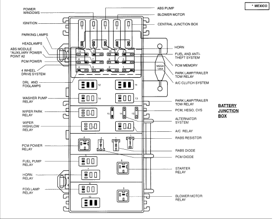

where is the fan heater relay located?
Mar 30, 2021 at 2:00 PM (Merged)
  • 75,992 POSTS
THe blower relay is under the hood here is a guide to hell check it with the location in the diagrams below.
