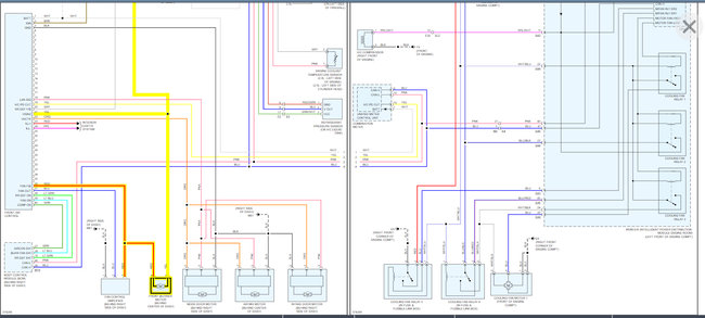

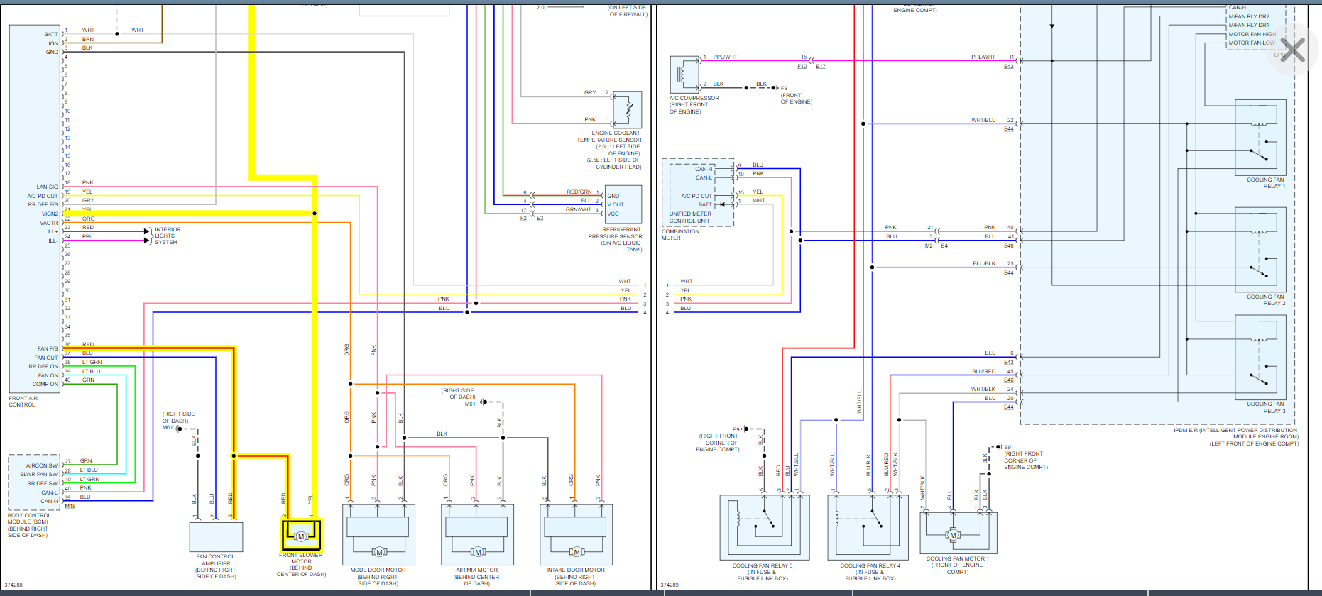

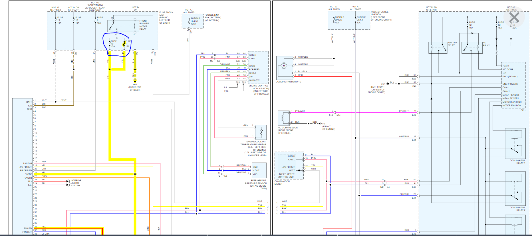

I attached a wiring diagram for you to view. Check the 2 fuses I circled.

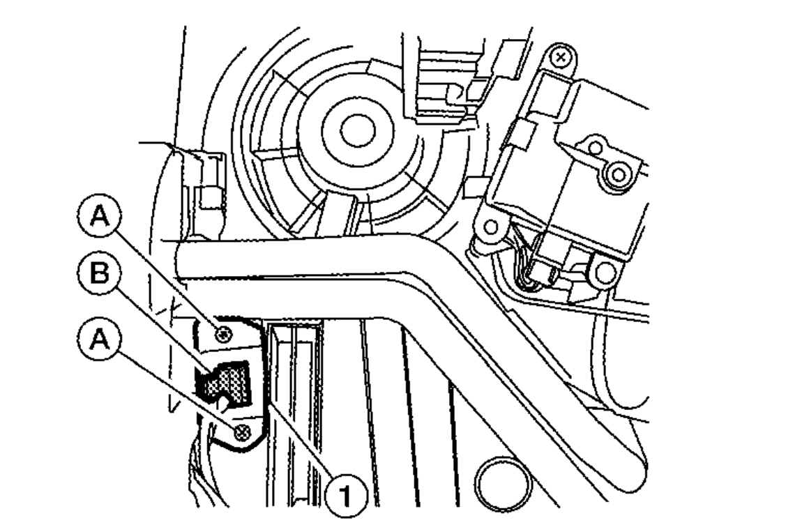

The resistor is the most common failure for this. I attached the procedure for you below.
REMOVAL
1.Remove the instrument lower finisher. See: Dashboard / Instrument Panel > Removal and Replacement > Removal And Installation.
2.Remove the front foot duct (LH).
3.Remove the accelerator pedal.
4.Disconnect the fan control amplifier connector (B).
5.Remove the two screws (A) from the fan control amplifier (1)
and then remove the fan control amplifier (1).
