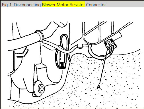

The blower fan goes off and on, but mainly off. The compressor is working fine. Sometimes when accelerating from a stop, the belt squeals, but it is on tight.

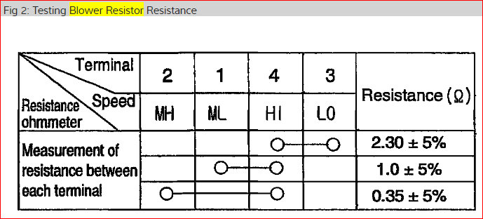

Jul 1, 2018 at 2:11 PM
DANNY L
  • 5,648 POSTS
Hello, Danny again.
You might be having a problem with the blower motor resistor. It could be loose, melted/bad connection. I am attaching a test guide and component picture if you want to test. It is located on the bottom of the HVAC unit under the dash on passenger side. Hope this helps and let me know if you have any further questions.
Danny-
